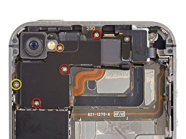

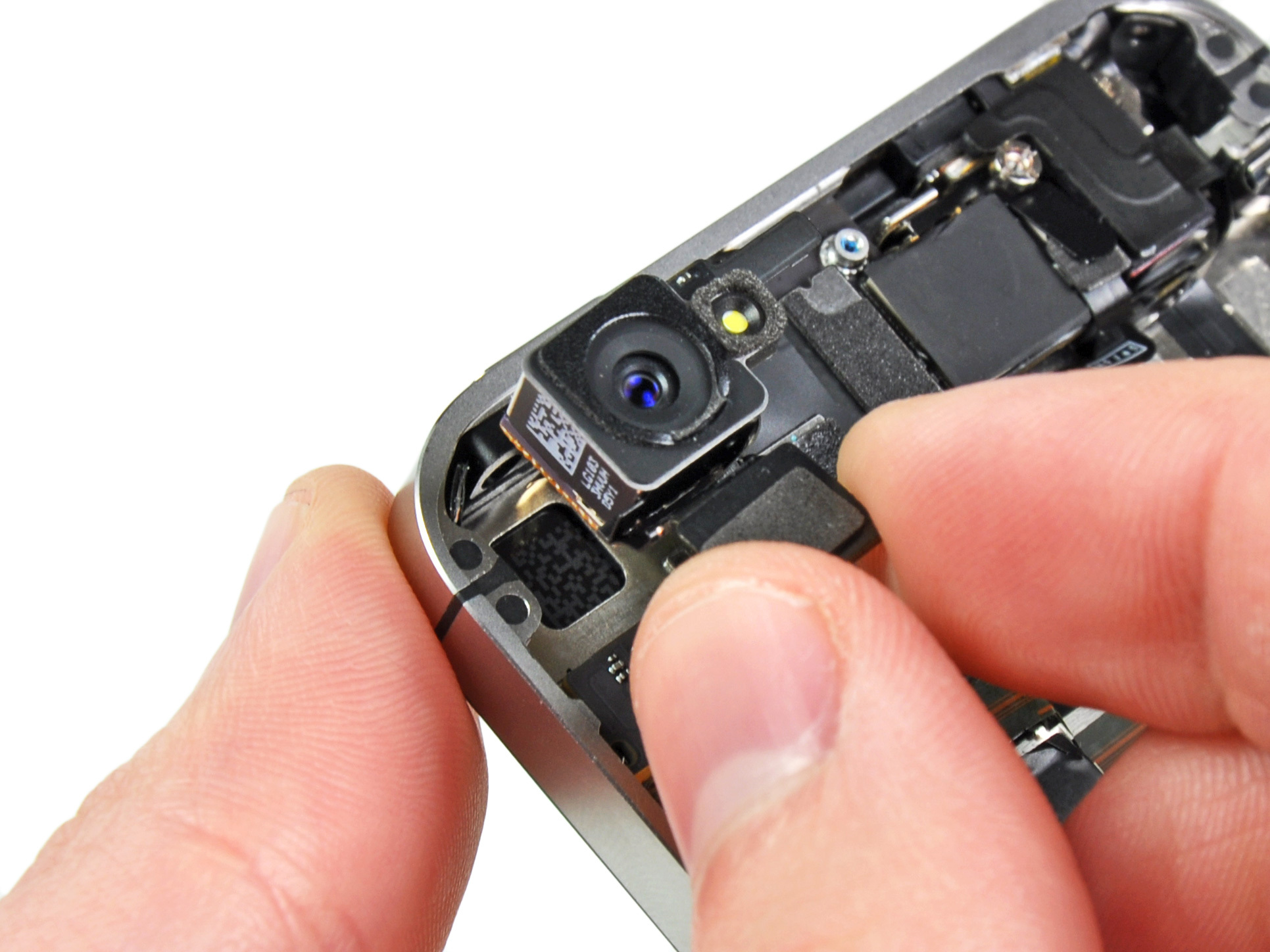

Add Note Edit Step 7 — Rear Camera  ¶
  • Remove the following five screws:
    • Three 1.3 mm Phillips screws
    • One 1.5 mm Phillips screw
    • One 2.4 mm Phillips screw

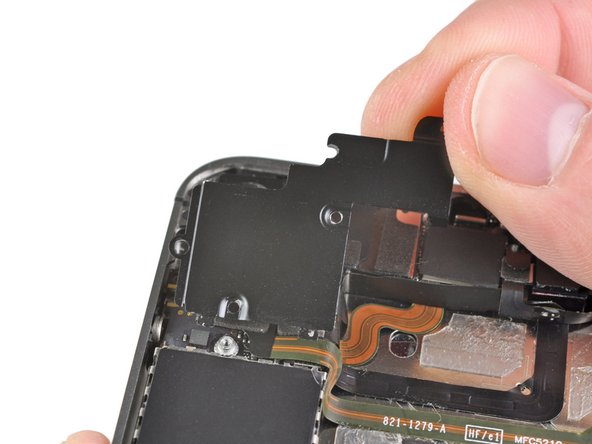

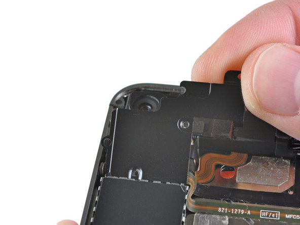

Add Note Edit Step 8  ¶
  • Lift the cable cover from its edge nearest the top of the iPhone.
  • Pull the cable cover tabs out of their slots cut into the EMI shield on the logic board and remove it from the iPhone.
