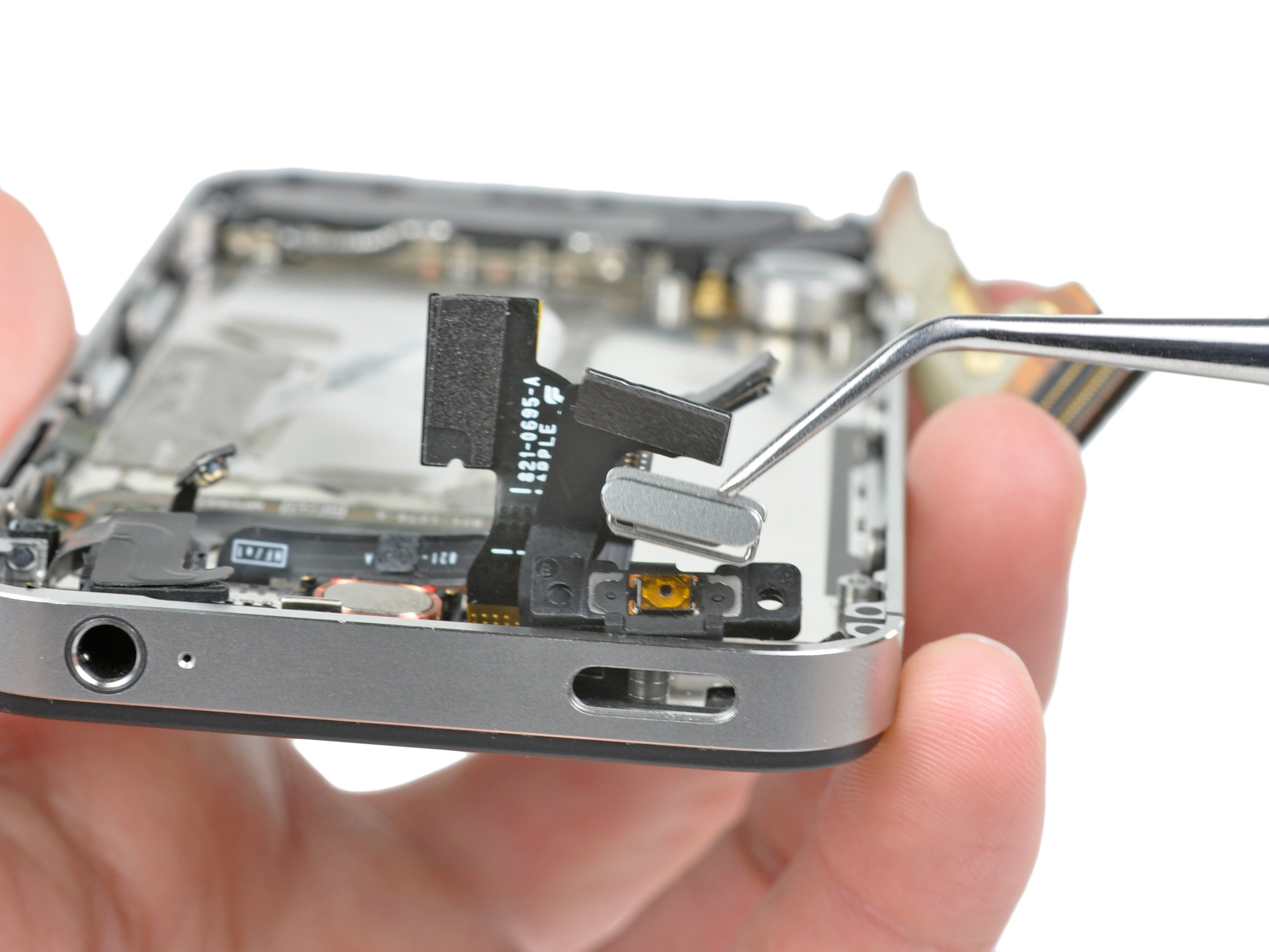

Add Note Edit Step 23 — Power Button  ¶
  • Remove the two 2.0 mm Phillips screws securing the power button bracket to the outer case.
  • Slightly pull the power button bracket away from the outer case.
first image
Add Note Edit Step 24  ¶
  • Use a pair of tweezers to remove the power button from the iPhone.
