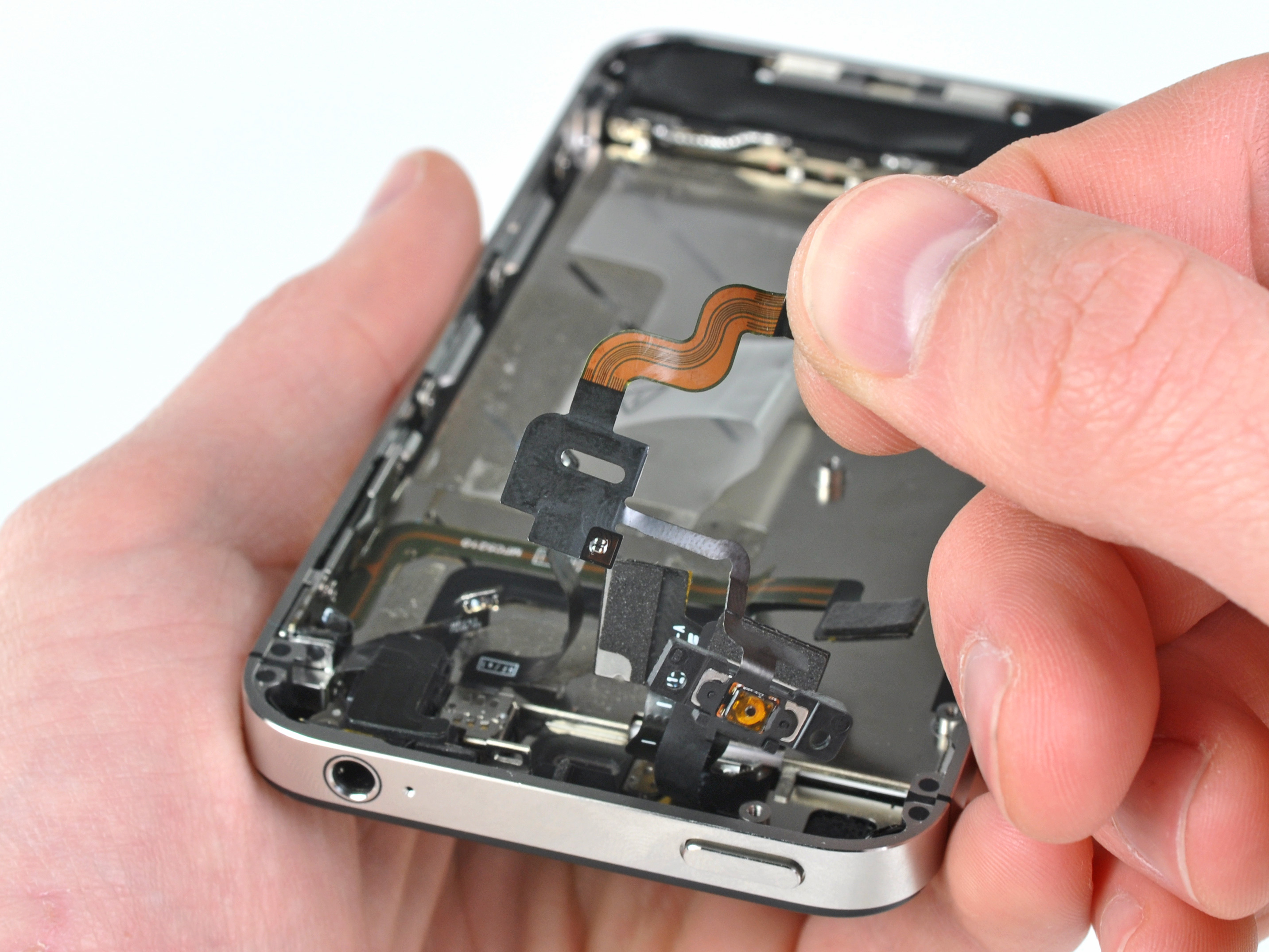

Add Note Edit Step 26  ¶
  • Use a plastic opening tool to gently peel up the power button cable from the outer case.
  • Remove the power button cable from the iPhone.
first image
Add Note Edit Step 27  ¶
  • Use a plastic opening tool to remove the metal power button bracket from the power button switch.
  • Transfer this bracket to your new power button cable.
