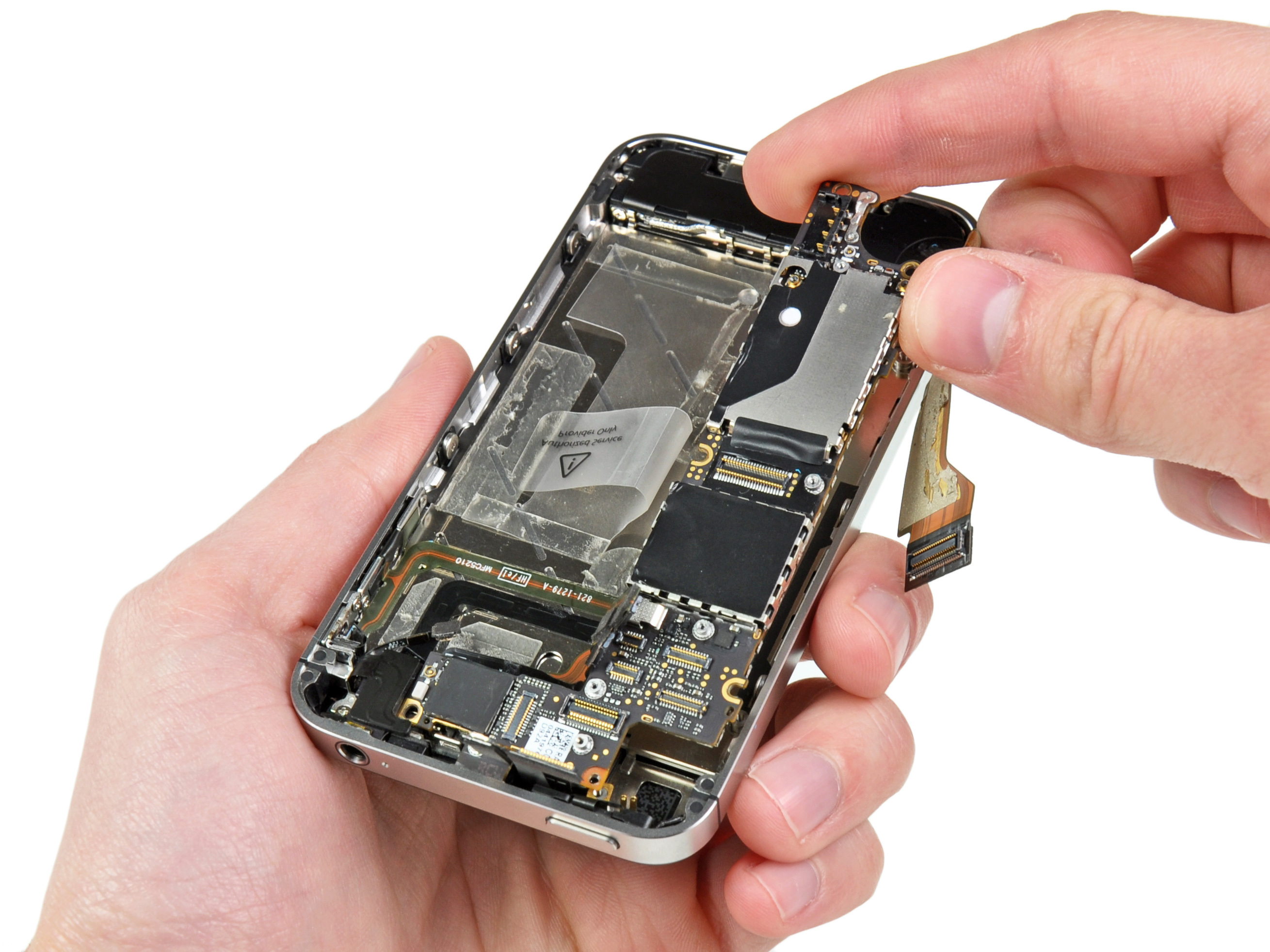

Add Note Edit Step 15 — Logic Board  ¶
  • Remove the five cables near the top of the logic board in the following order:
    • Headphone jack/volume button cable
    • Power button cable
    • Front facing camera cable
    • Digitizer cable
    • Display data cable
  • To disconnect the cables, use the edge of a plastic opening tool to gently lift their connectors up and out of the sockets on the logic board.
  • Be careful not to break any of the small and delicate surface mount components as you disconnect the cables.

Add Note Edit Step 21  ¶
  • Carefully lift the logic board from the end closest to the speaker enclosure and slide it away from the top edge of the iPhone.
  • Remove the logic board.
  • Before reassembly, be sure to clean all metal-to-metal contact points on the logic board (not the mating halves of connectors) with a de-greaser such as windex or isopropyl alcohol. The oils on your fingers have the potential to cause grounding issues.
first image
