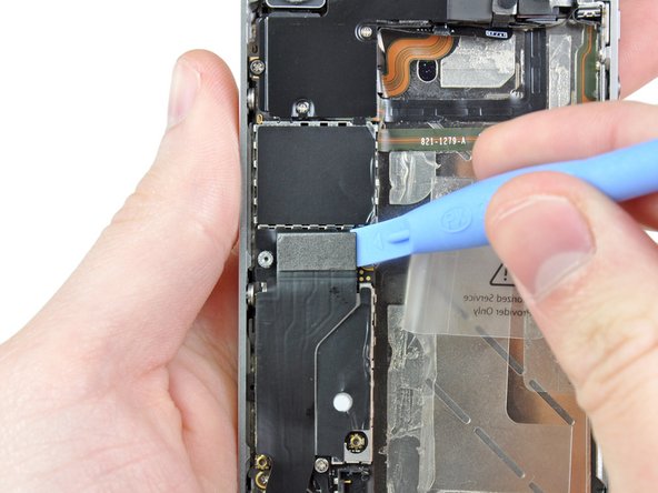

Add Note Edit Step 4 — Battery  ¶
  • Remove the single 1.5 mm Phillips screw securing the battery connector to the logic board.
first image
Add Note Edit Step 5  ¶
  • Use the edge of a plastic opening tool to gently pry the battery connector up from its socket on the logic board.
first image

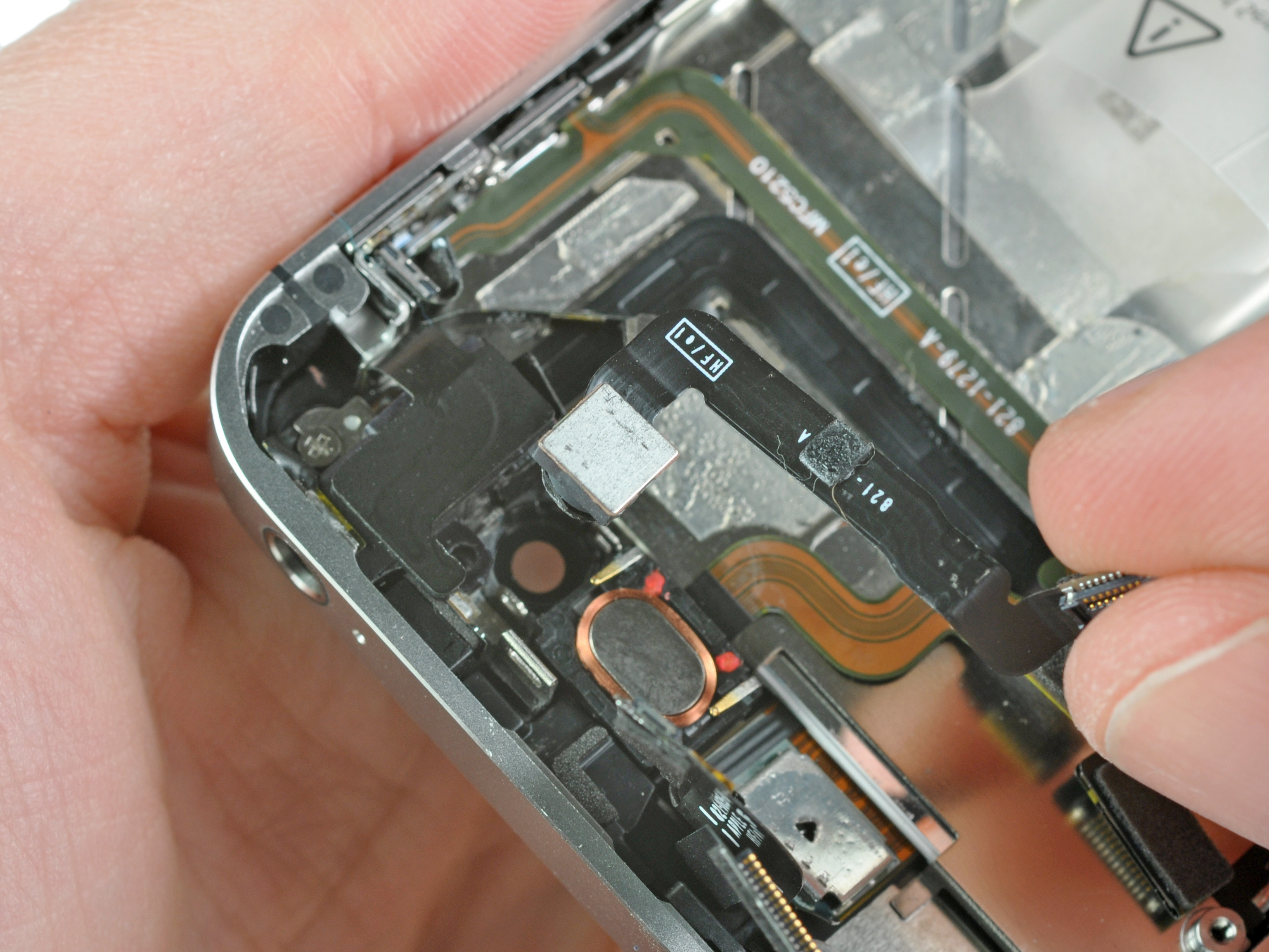

Add Note Edit Step 15 — Logic Board  ¶
  • Remove the five cables near the top of the logic board in the following order:
    • Headphone jack/volume button cable
    • Power button cable
    • Front facing camera cable
    • Digitizer cable
    • Display data cable
  • To disconnect the cables, use the edge of a plastic opening tool to gently lift their connectors up and out of the sockets on the logic board.
  • Be careful not to break any of the small and delicate surface mount components as you disconnect the cables.
first image
thumb image 1
thumb image 2
