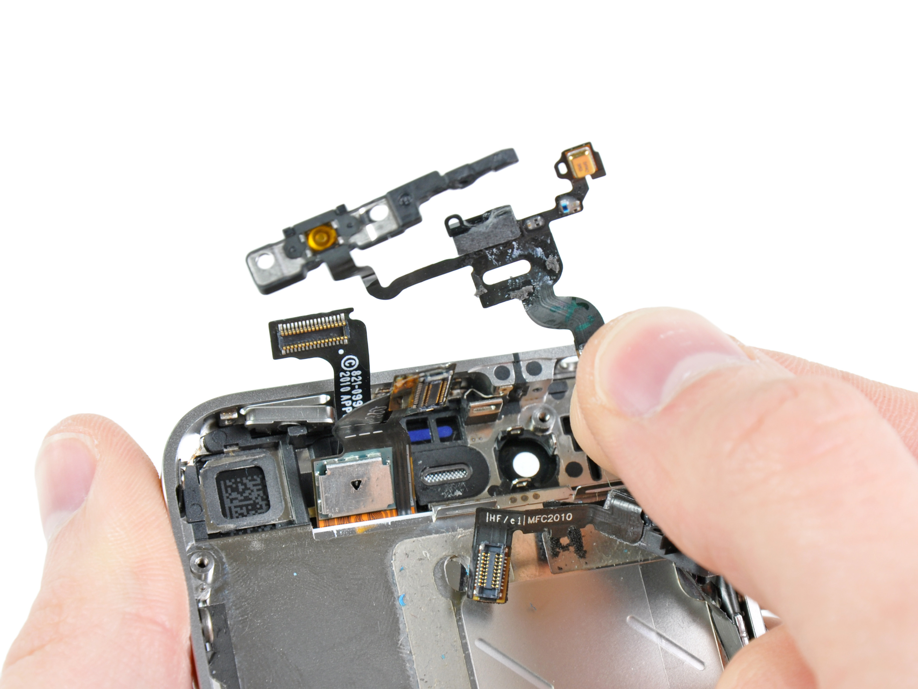

Add Note Edit Step 14  ¶
  • Use an iPod opening tool to carefully lift the rear camera connector up off its socket on the logic board.
  • Remove the rear camera.
Image #1 Image #2
Add Note Edit Step 15  ¶
  • Remove the small circular white sticker (warranty sticker and water indicator) covering the screw near the battery pull tab.
  • Remove the 2.4 mm Phillips screw that was hidden underneath the sticker.
Image #1
Add Note Edit Step 16  ¶
  • Use the edge of a plastic opening tool to gently pry the following connectors up and out of their sockets on the logic board:
    • Digitizer cable (pry from bottom)
    • LCD cable (pry from bottom)
    • Headphone jack/volume button cable (pry from top)
    • Top Microphone/sleep button cable (pry from top)
    • Front camera cable (pry from top)
