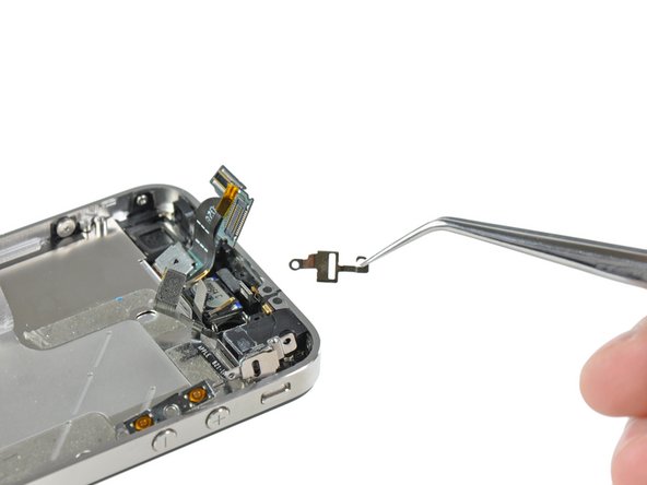

Image #1 Image #2
Add Note Edit Step 19 — Front Facing Camera  ¶
  • Use the edge of an iPod opening tool to lift the thin steel front camera retainer off the front camera.
  • Remove the front camera retainer.

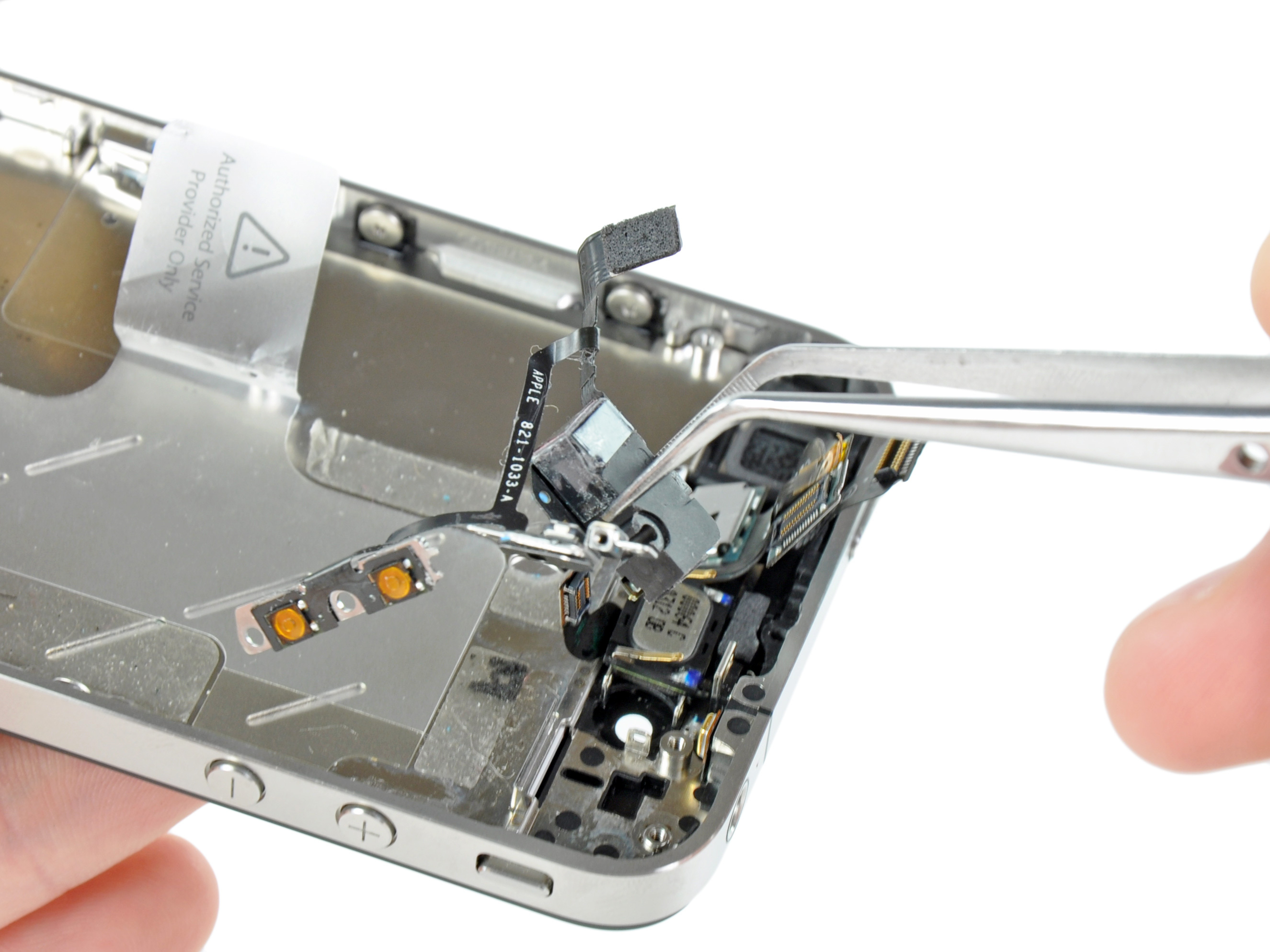

Image #1 Image #2
Add Note Edit Step 24  ¶
  • Use a pair of tweezers to carefully pull the silent switch and its bracket from the side of the outer case.
  • Don't try to completely remove the silent switch just yet.
