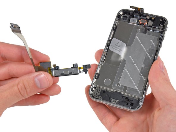

Image #1
Add Note Edit Step 25  ¶
  • Remove the dock connector assembly from the iPhone, minding any cables that may get caught.
Image #1
Add Note Edit Step 26  ¶
  • Slide the rubber cover off the microphone attached to the old dock connector and transfer it to your new dock connector.
  • The ribbon is very fragile and can easily be torn when placing the rubber cover onto your new part.
    • If your microphone does not work after replacing your dock connector, the issue may be that the rubber cover is not positioned properly on the mic cable.
