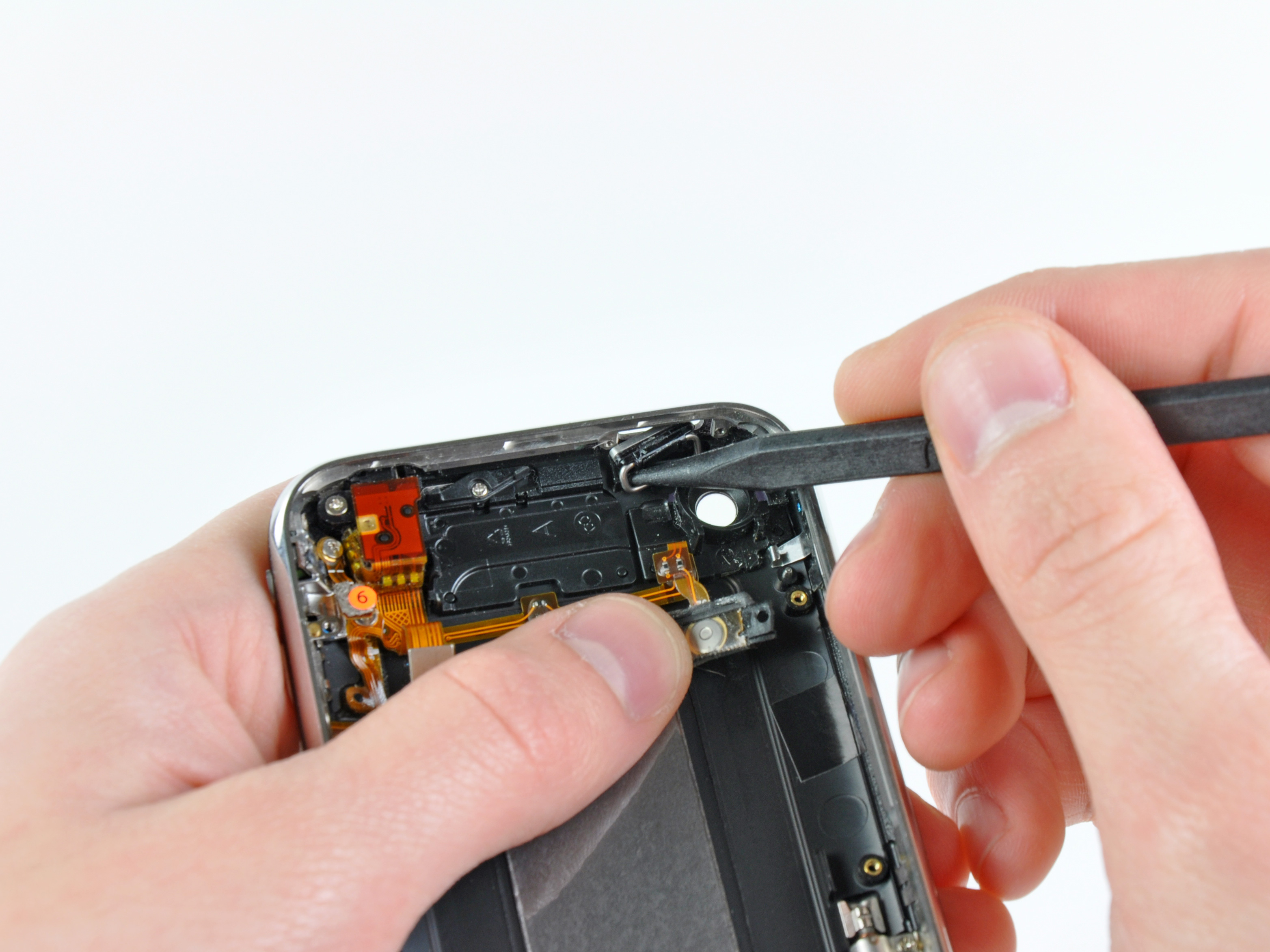

  • Insert your SIM eject tool or a paper clip into the hole next to the headphone jack.
  • Press down on the tool until the SIM card tray pops out.
  • Grasp the SIM card tray and slide it out of the iPhone.
Image #1
Add Note Edit Step 8  ¶
  • Use a spudger to disconnect the ribbon cable labeled "4."
