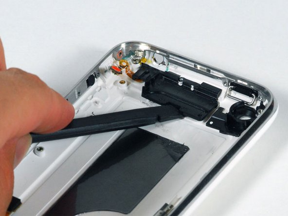

Add Note Edit Step 23 — GPS Antenna  ¶
  • Remove the single 2.4mm Phillips #00 screw securing the black plastic spacer.
  • Some replacement rear panels may not have a threaded screw hole in this location.
Image #1
Add Note Edit Step 24  ¶
  • Use a spudger to pry up the black plastic antenna housing from the rear panel.
  • Lift the black plastic GPS antenna housing out of the iPhone.
