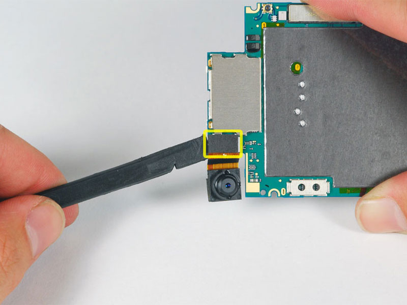

Add Note Edit Step 16  ¶
  • Use a spudger to disconnect the camera from the logic board.
