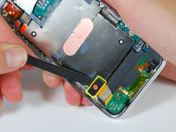

  • Use a spudger to disconnect the ribbon cable labeled "4."

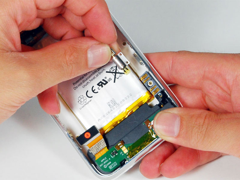

  • Remove the two Phillips #00 screws securing the vibrator to the rear panel.
  • These screws are smaller diameter than all the others. Make sure you don't mix them up with the other screws. On reassembly, only these two screws will fit.
first image
Add Note Edit Step 17  ¶
  • Lift the vibrator up and out of the iPhone.
