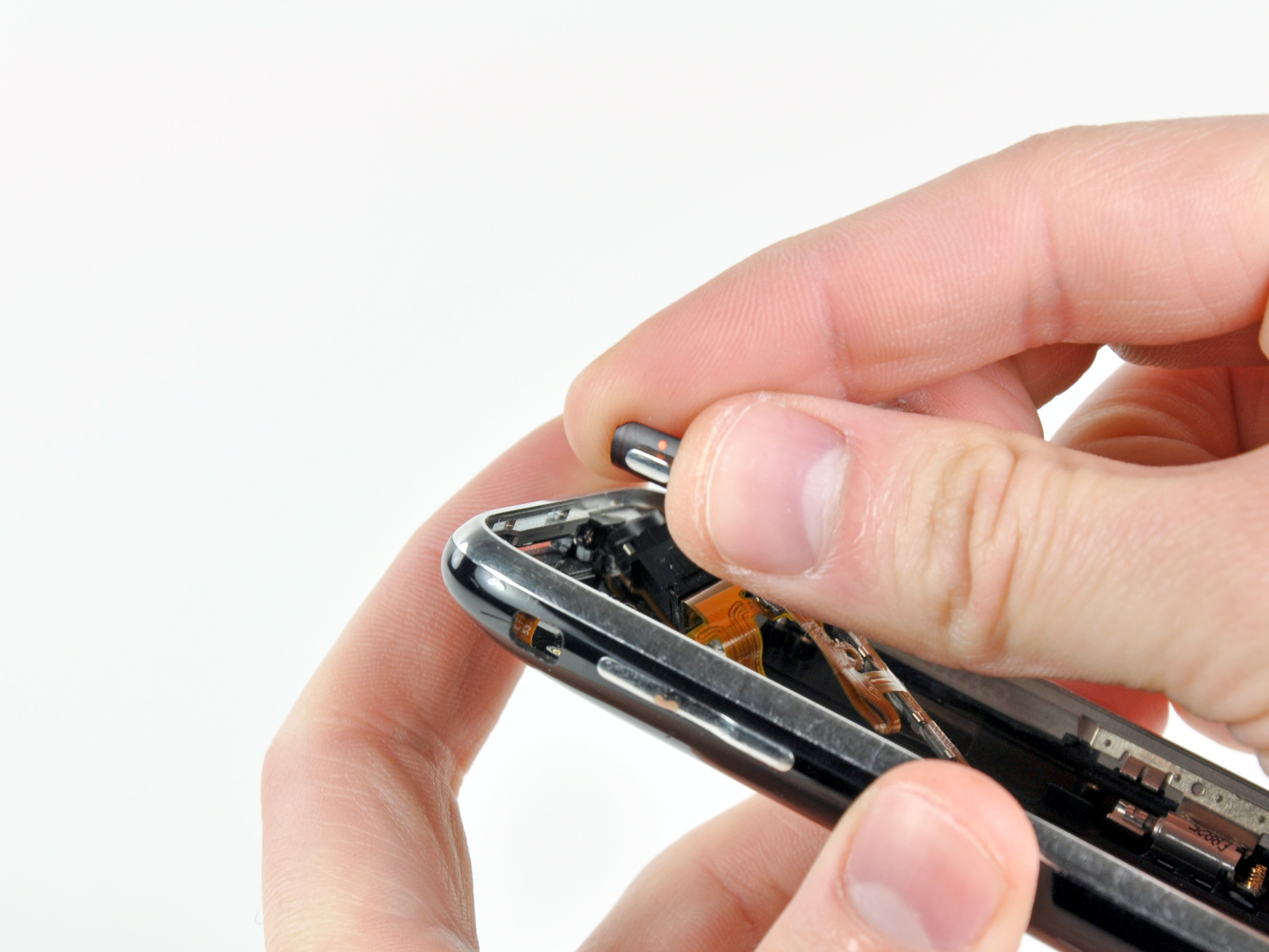

Add Note Edit Step 20  ¶
  • Gently pull the headphone jack electronics away from the side of the rear panel to reveal the plastic mute button.
first image
Add Note Edit Step 21  ¶
  • Remove the mute button from the rear case.
