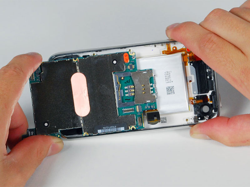

    • Use a spudger to gently pry up the end of the logic board closest to the dock connector.
    • If the board won't lift up, double check to make sure all the screws securing the logic board have been removed.
  16. iPhone 3G Logic Board Replacement: step 16, image 1 of 1
    • Slide the logic board towards the dock connector and out of the iPhone.
  17. iPhone 3G Logic Board Replacement: step 17, image 1 of 1
    • Use a spudger to disconnect the camera from the logic board.
