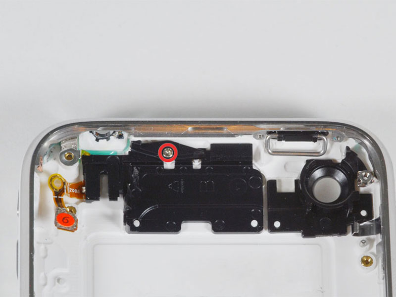

Add Note Edit Step 23 — GPS Antenna  ¶
  • Remove the single Phillips #00 screw securing the black plastic spacer.
  • Some replacement rear panels may not have a threaded screw hole in this location.
first image
Add Note Edit Step 24  ¶
  • Use a spudger to pry up the black plastic antenna housing from the rear panel.
  • Lift the black plastic antenna housing out of the iPhone.
