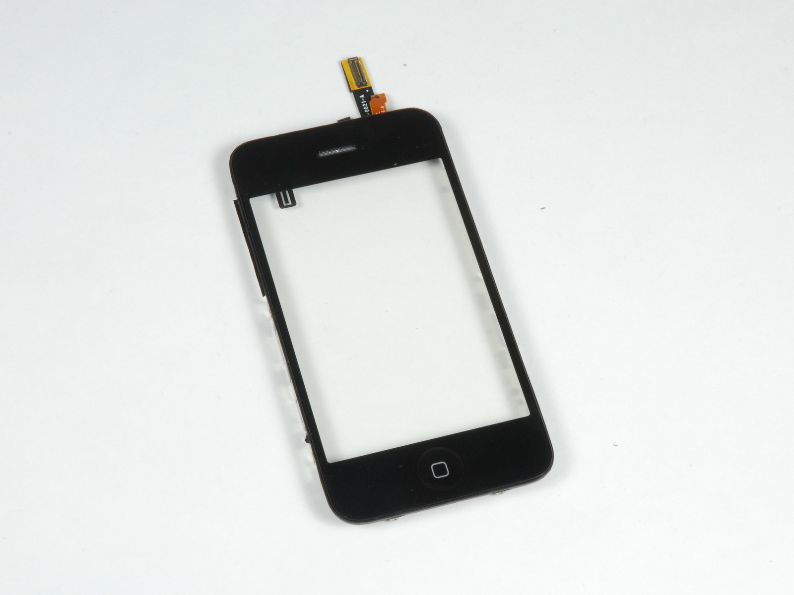

Installing iPhone 3G Front Panel Assembly
Replace a cracked front panel assembly on your iPhone 3G.
  • Add Note x
  • x 155
The front panel assembly, including the digitizer, ear speaker, and home button, can be replaced on the iPhone 3G.
