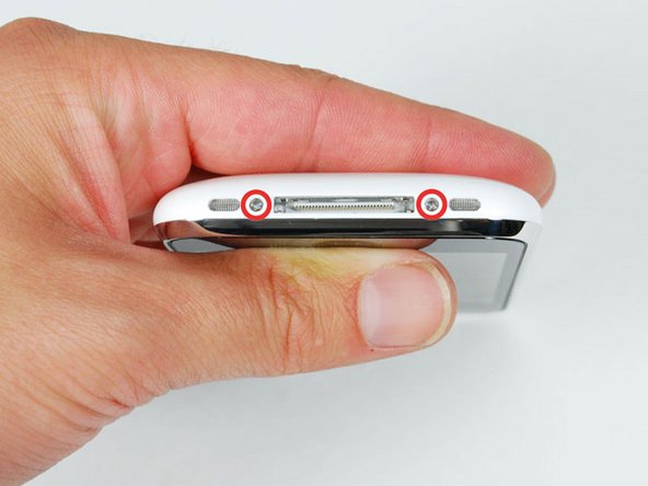

Add Note Edit Step 1 — Display Assembly  ¶
  • Remove the two Phillips #00 screws from the dock-connector end of the iPhone.

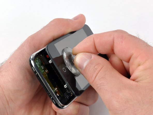

Add Note Edit Step 2  ¶
  • Remove the metal handle from the suction cup. It's easier and safer to grip the suction cup's base instead of the metal handle.
  • Be very careful when opening the iPhone so that the cables under the display are not severed.
  • There is a rubber gasket between the silver front bezel and black display assembly. A bit of force is required in this step to separate the iPhone's display assembly.
  • Use a small suction cup near the Home button to gently pull up the bottom portion of the iPhone's display assembly.
  • If the display assembly is too damaged to allow the suction cup to adhere, tape with a strong adhesive such as duct tape maybe used.

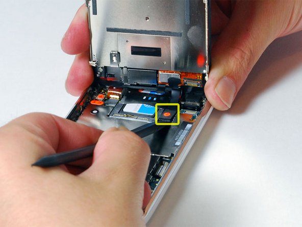

Add Note Edit Step 4  ¶
  • Continue to hold the display assembly with one hand, and use your other hand and a spudger to disconnect the black ribbon cable labeled "1."
first image

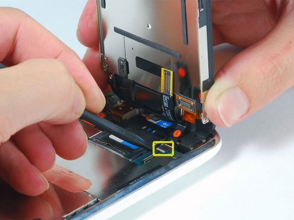

Add Note Edit Step 5  ¶
  • Rotate the display assembly up until it is roughly vertical. This will allow easier access for disconnecting the remaining cables.
  • Use a spudger to disconnect the black ribbon cable labeled "2."
first image

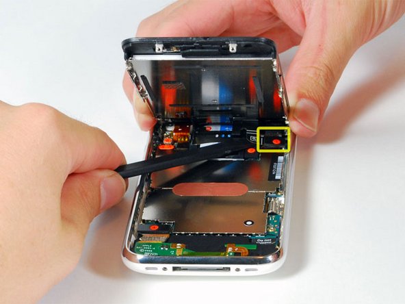

Add Note Edit Step 6  ¶
  • Use a spudger to flip up the black plastic tab holding the remaining ribbon cable in place. The black will rotate up 90 degrees, releasing the ribbon cable.
  • The tab is very fragile, so be careful when flipping it up to unlock the cable and down to lock the cable.
  • The plastic tab may be white (instead of black) on some iPhone models.
  • Slide the ribbon cable out of its connector, and remove the display assembly from the iPhone.

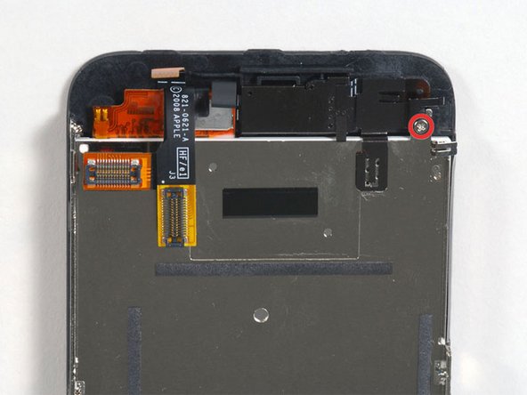

Add Note Edit Step 7 — Earpiece Speaker  ¶
  • Remove the single Phillips #00 screw from the corner of the display assembly.
first image

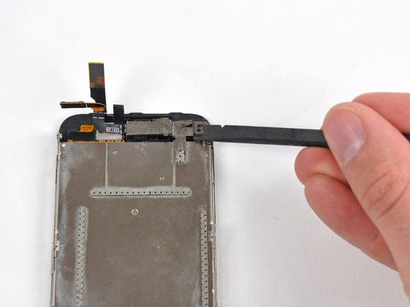

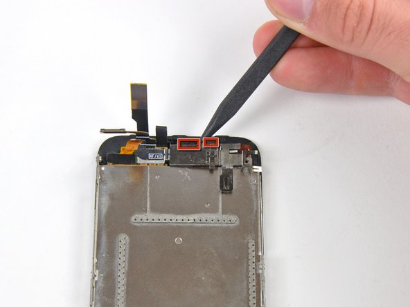

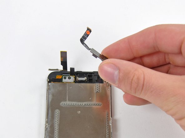

Add Note Edit Step 8  ¶
  • Use the flat end of a spudger to pry up the right side of the ear speaker cover assembly.
    • Do not try to pry the assembly all the way off, as it is still connected at two points.
  • Turn the spudger around and use the pointed side to detach the two clips securing the top of the assembly.
  • Once the clips are detached, lift the cover assembly up from the device.

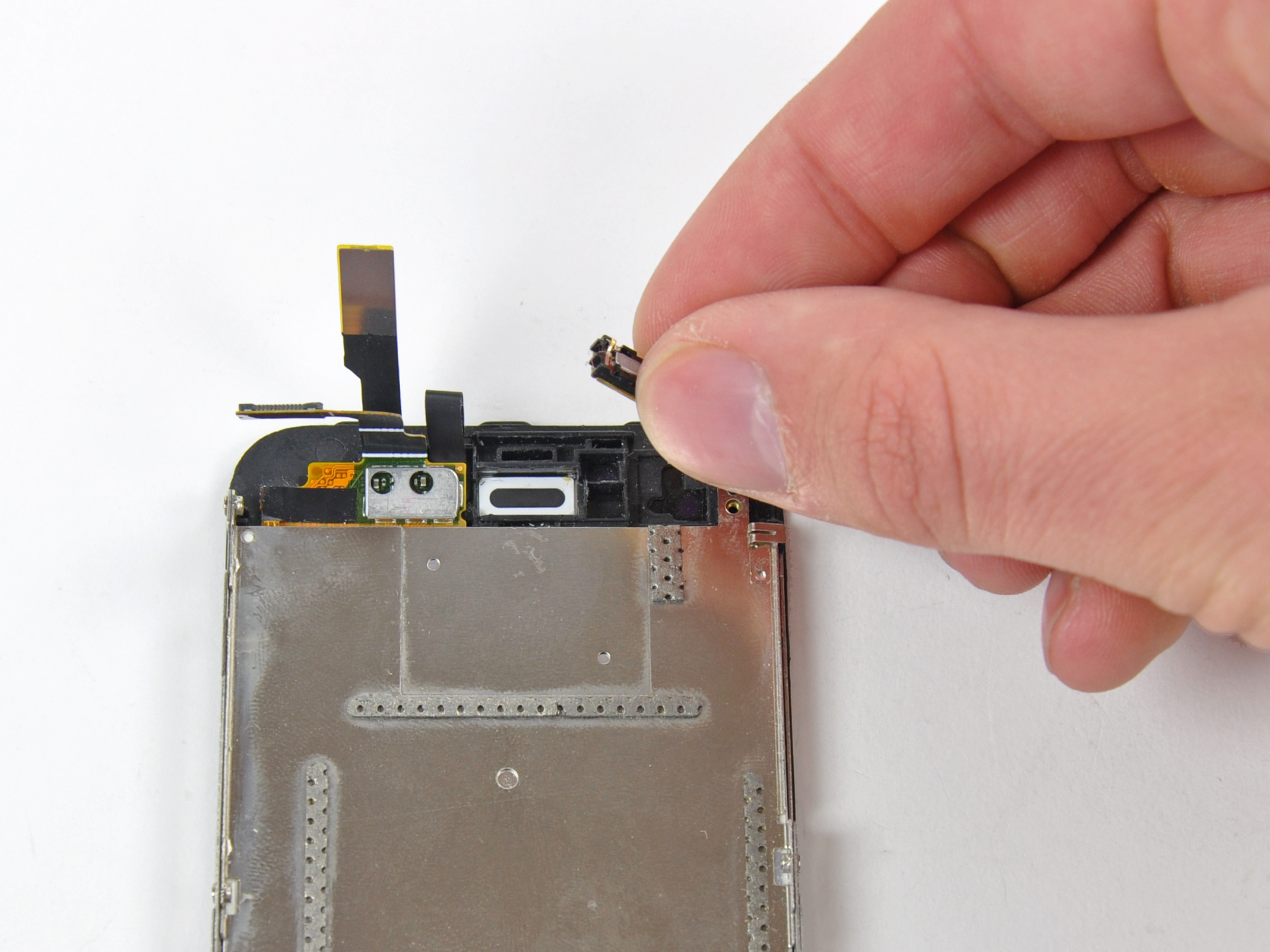

Add Note Edit Step 9  ¶
  • Slide the pointed end of the spudger into the slot under the upper right corner of the ear speaker and gently pry upwards.
    • Be careful during this step, as the upper portion of the speaker can easily detach from the lower portion, causing the coil inside to unwind. Be sure to pry the entire assembly up.
  • Lift the ear speaker up and out of the device.
