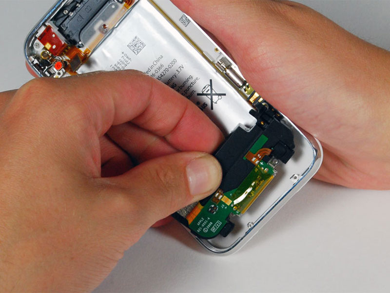

Add Note Edit Step 17  ¶
  • Lift the dock connector assembly up and out of the iPhone.
  • When inserting the new assembly, ensure the screw holes of the assembly rest ABOVE the bezel's holes.
