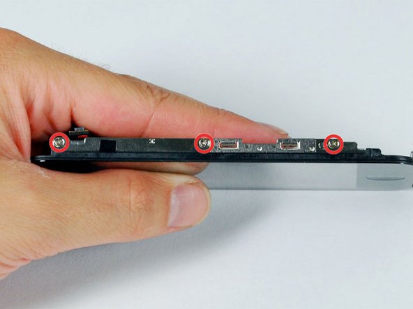

  • Remove the three Phillips #00 screws from the left side of the display assembly.
