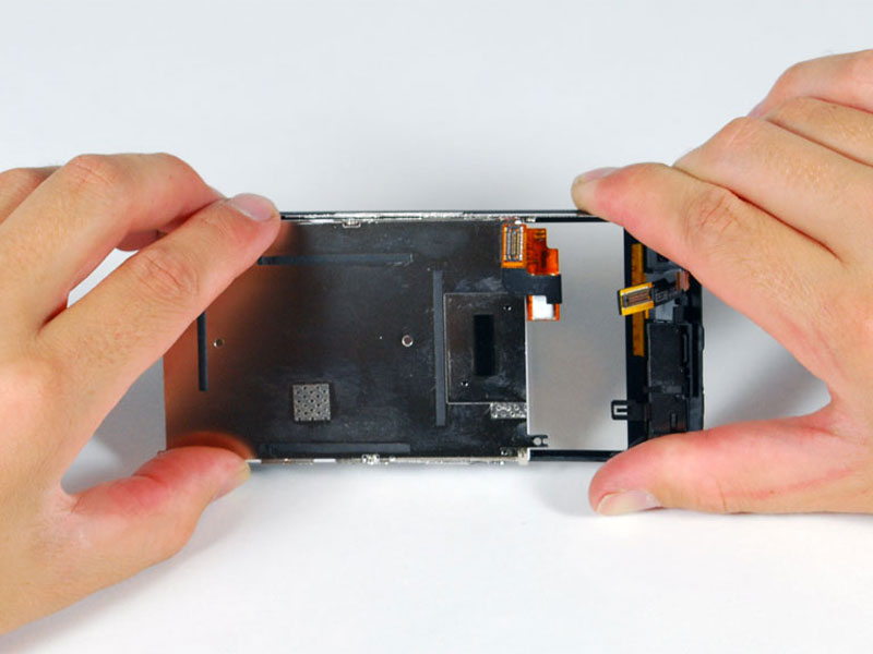

  • Turn the display assembly over and again carefully insert a metal spudger between the two metal rails along the edge of the display assembly. Gently rotate the spudger to lift the LCD up from the glass.
first image
Add Note Edit Step 12  ¶
  • Separate the LCD and glass by sliding the LCD panel away from the ribbon cables on the glass.
