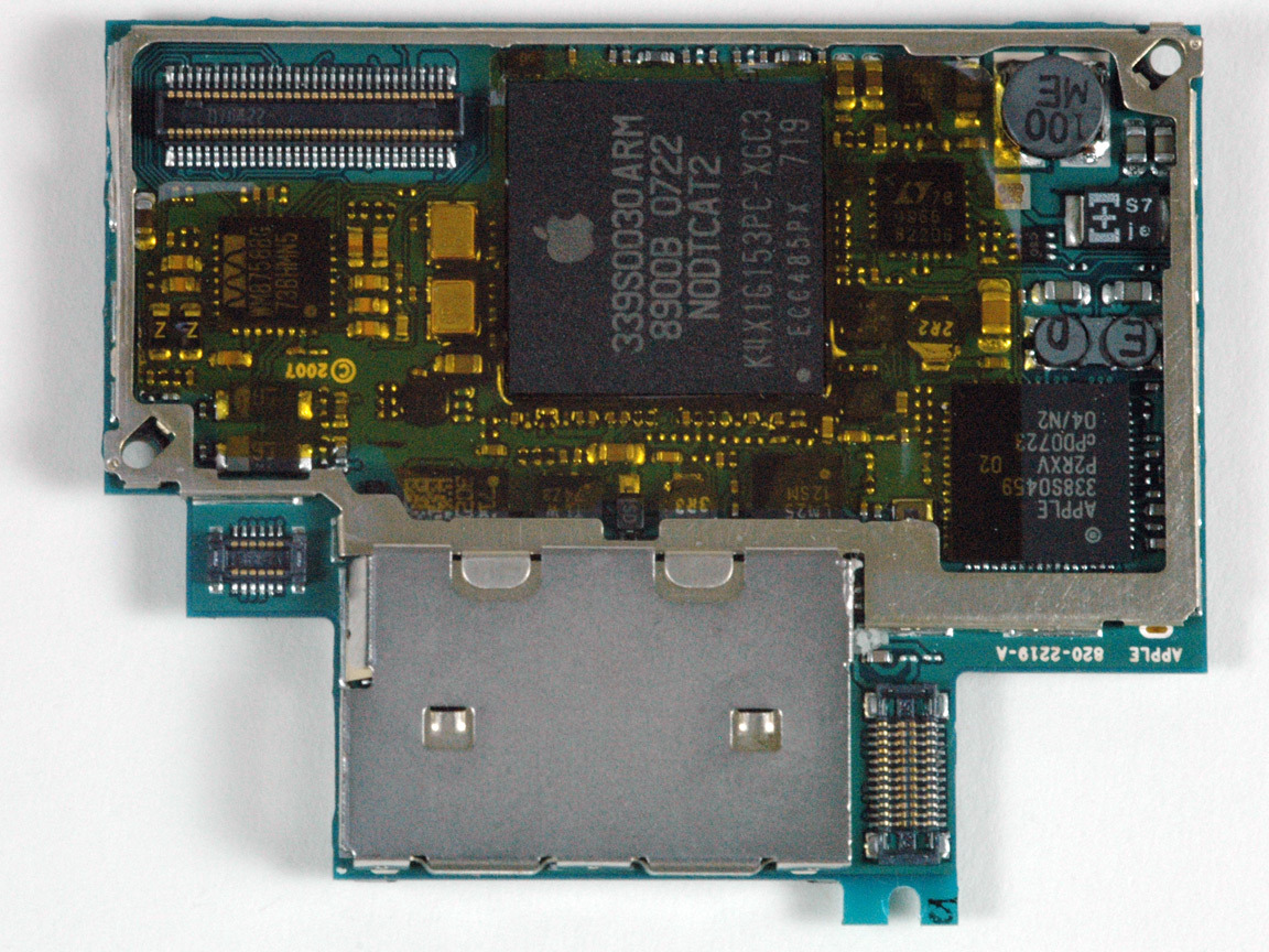

Add Note Edit Step 27  ¶
  • There are two stacked circuit boards on the iPhone. The communcations board is on the top, and the logic board is located on the bottom.
  • To separate the boards, insert a spudger into the gap in the metal shielding as shown. Carefully pry with the spudger to loosen the connector.
first image
Add Note Edit Step 28  ¶
  • Continue to separate the two boards. The silver metal shielding may not immediately separate. If necessary, work around the edge of the board to separate the metal shielding.
  • If you are replacing the communications board, you need to desolder it from the battery. The battery replacement guide can help you remove the battery.
first image
Add Note Edit Step 29 — Logic Board  ¶
  • Logic board remains.
For more information, check out the iPhone 1st Generation device page.
