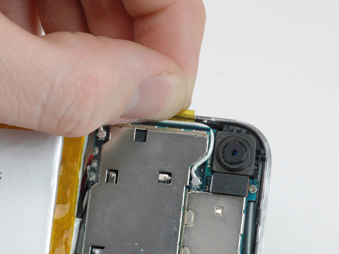

Add Note Edit Step 15 — Communications Board  ¶
  • Peel up the orange tape securing the white antenna cable to the side of the iPhone.
