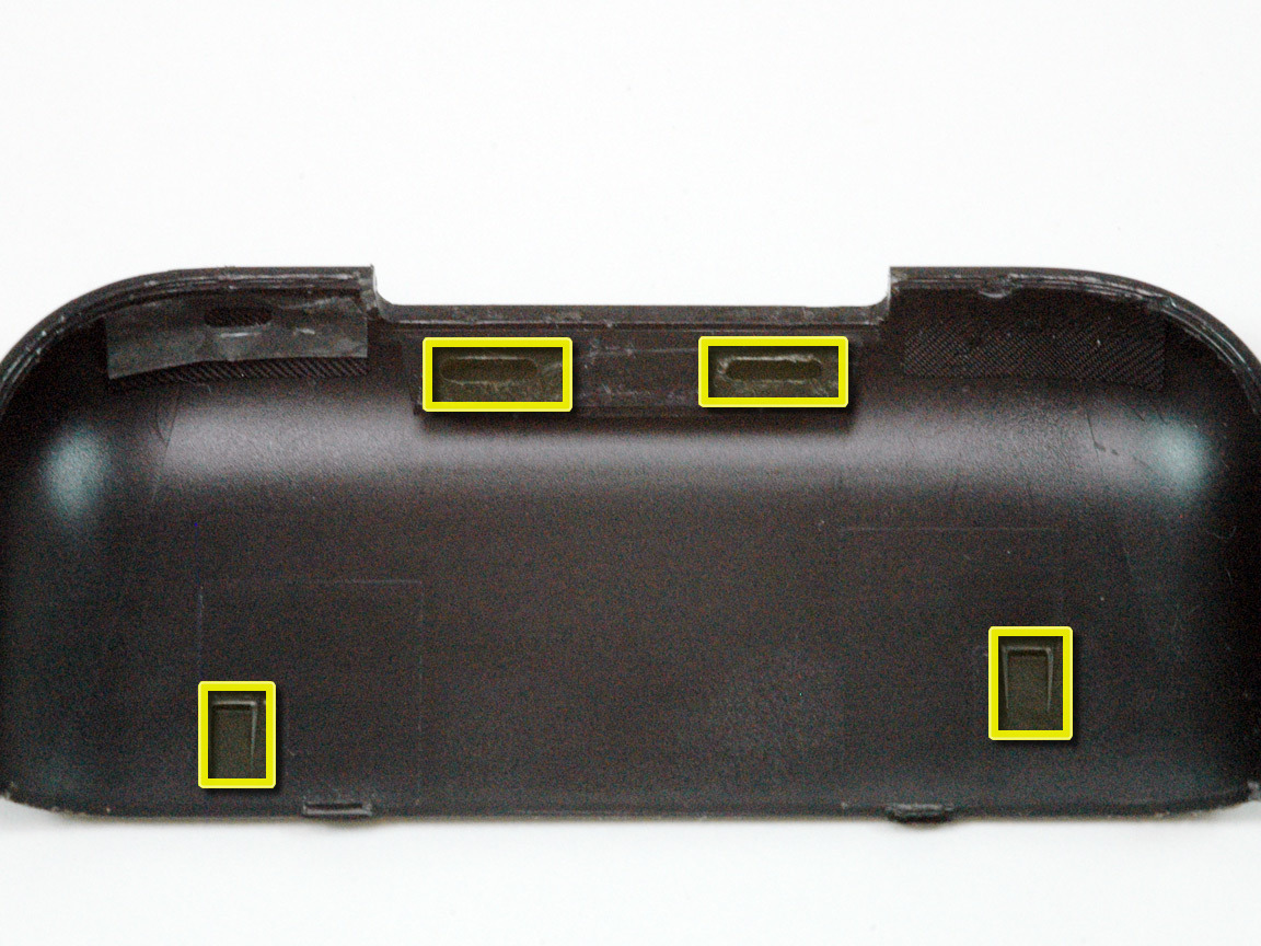

Add Note Edit Step 3 — Antenna Cover  ¶
  • This image shows the two tabs and two catches located on the underside of the antenna cover. The two tabs at the top of the image must be pushed towards the black cover to release them.
