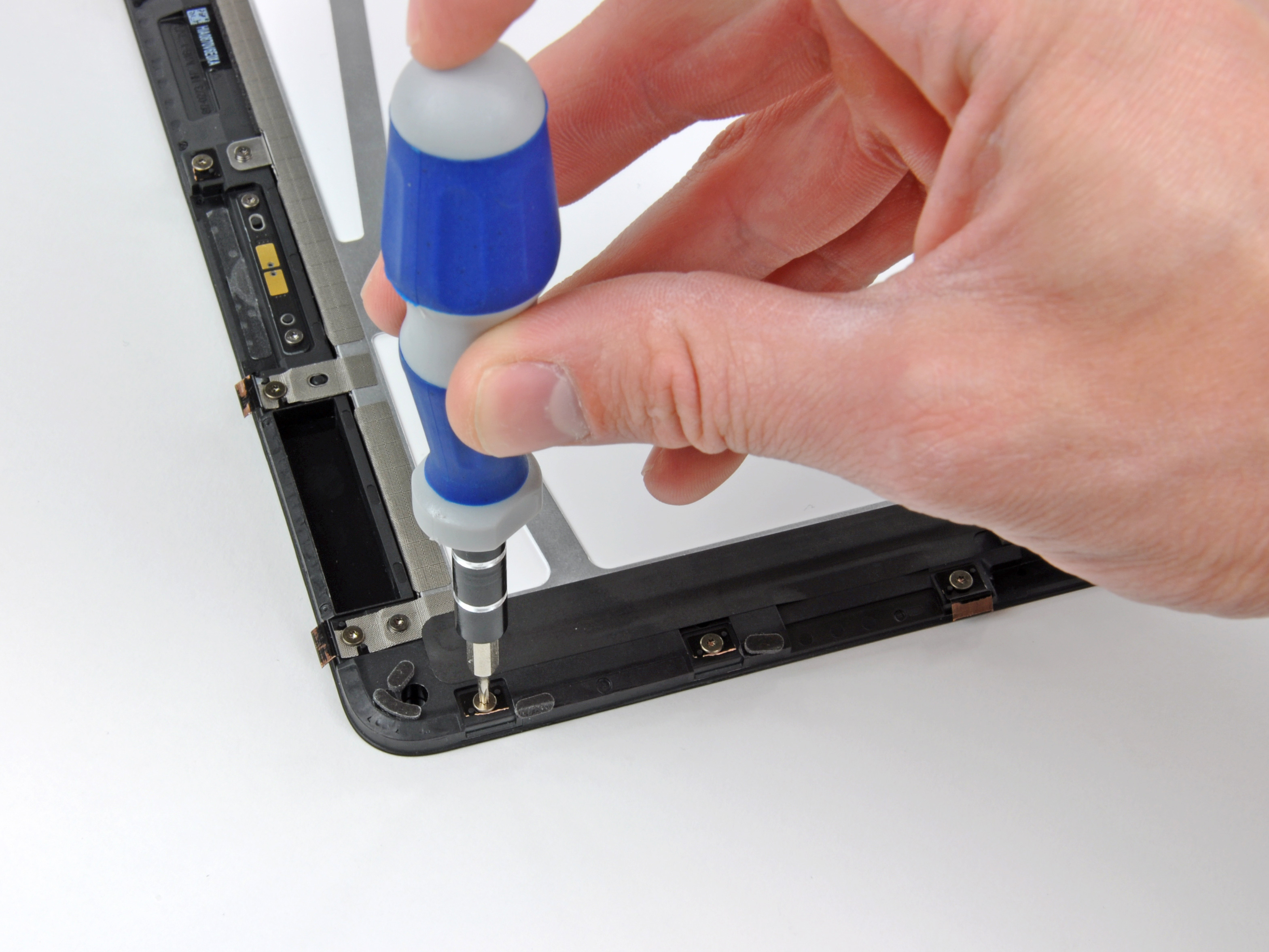

Add Note Edit Step 9 — Metal Display Clips  ¶
  • During the display assembly removal process, it is highly likely that the metal clips around the perimeter of the of the display assembly will break.
  • To replace a broken clip, first remove the T5 Torx screw securing the broken base of the clip to the display assembly.
  • Place a new clip on the positioning pins molded into the display frame, and reinstall the T5 Torx screw to secure the two pieces together.
  • Repeat this process for any other broken clips around your display assembly.
