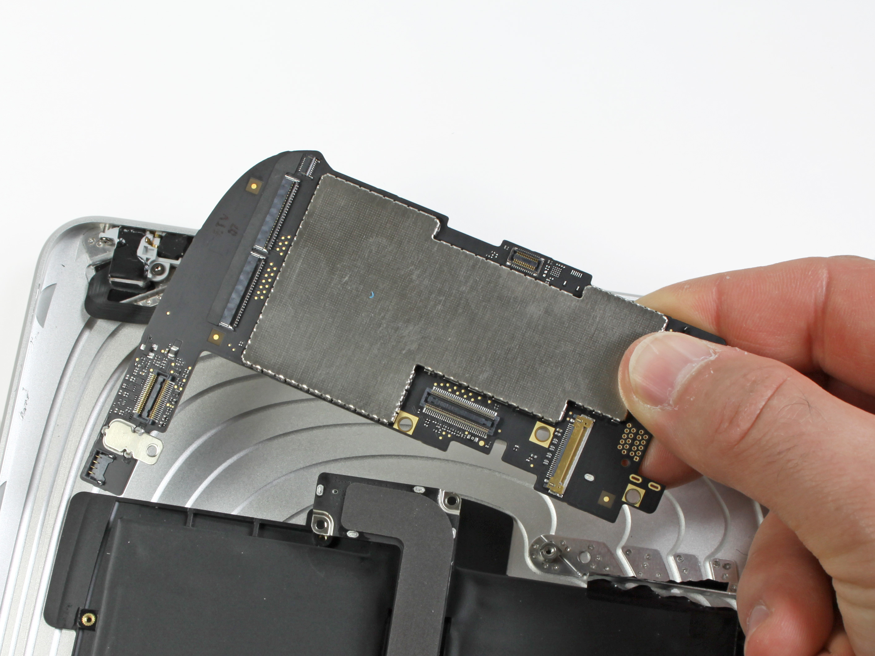

Add Note Edit Step 11  ¶
  • Use the edge of a plastic opening tool to carefully pry the dock cable connector straight up off the logic board.
  • Lift the logic board out of the rear panel assembly.
