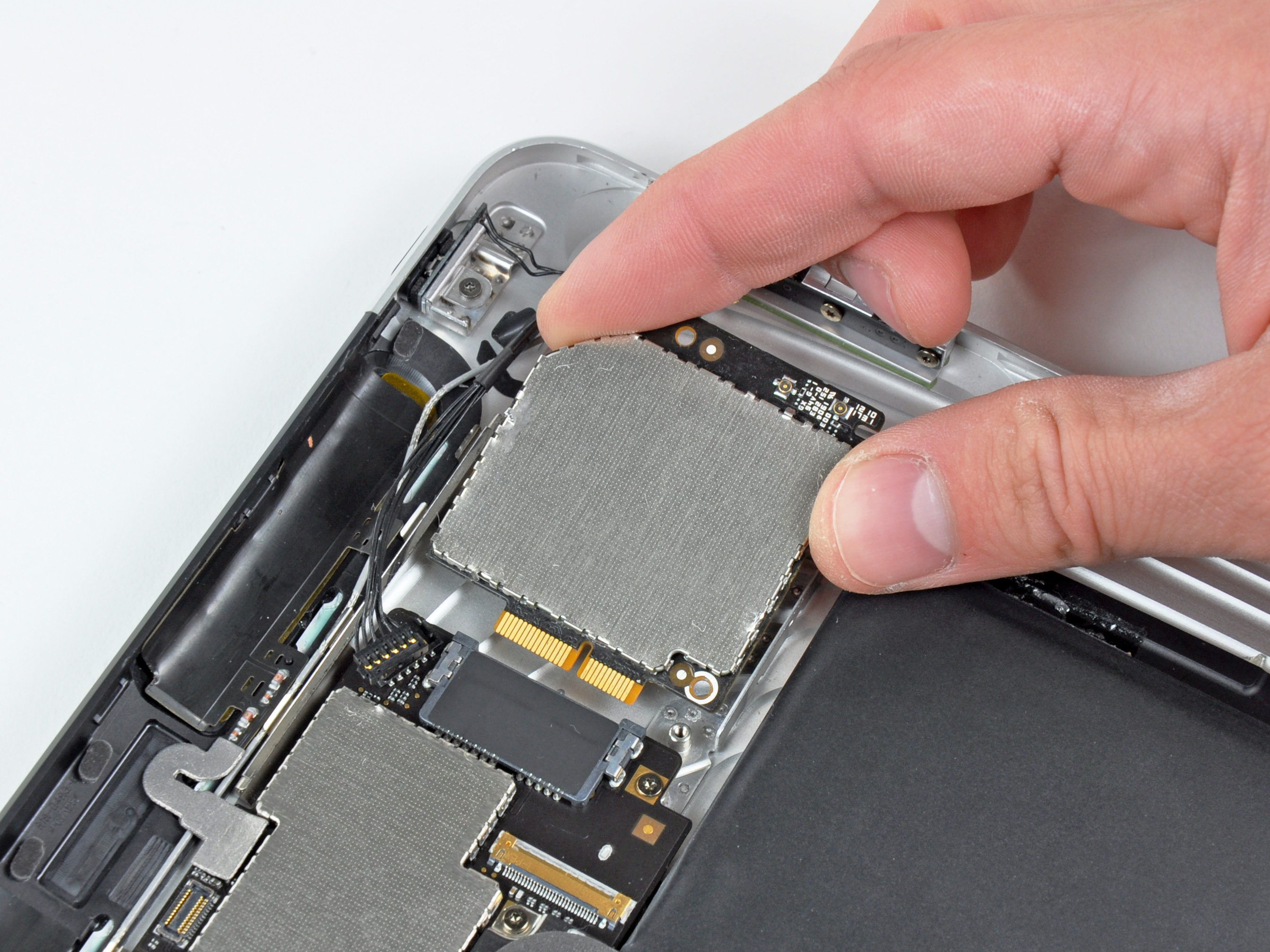

  15. iPad 3G Communications Board Replacement: step 15, image 1 of 2 iPad 3G Communications Board Replacement: step 15, image 2 of 2
    • If necessary, lift the right edge of the communications board upward to release it from the adhesive pad attached to the rear case.
    • Pull the communications board away from its socket on the logic board.
