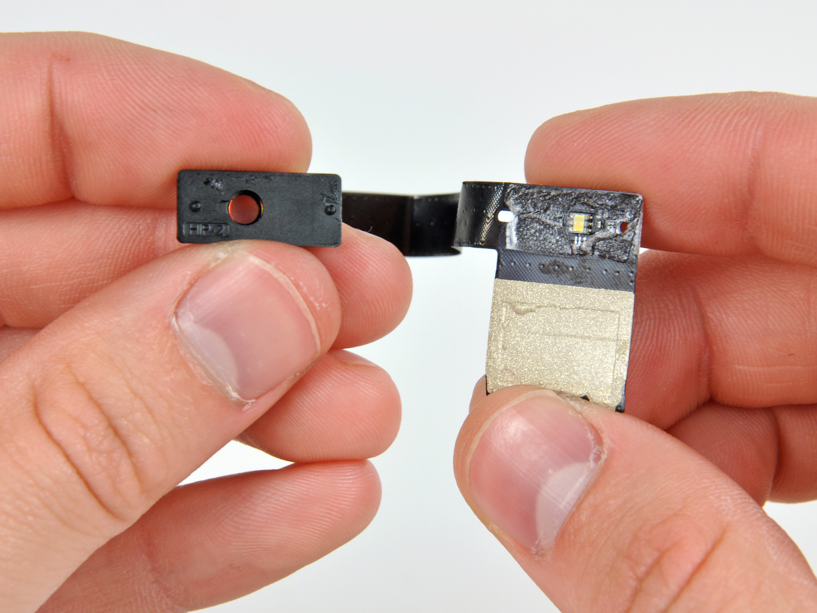

Installing iPad 3G Ambient Light Sensor
Replacing the ambient light sensor on your iPad 3G.

Use this guide to replace a broken ambient light sensor.

Add Note Edit Step 1 — Display Assembly  ¶
  • The iPad shown in the photos may look slightly different from your iPad, but the procedure is the same.
  • Insert a metal spudger between the right edge of the display assembly and the rear panel assembly.
  • Rotate the spudger away from you to release the tabs along the top edge of the display.

Add Note Edit Step 2  ¶
  • Insert a second metal spudger between the top edge of the display assembly and the rear panel assembly to keep the tabs from snapping back into place.
  • Pry the display assembly away from the rear panel.

Add Note Edit Step 3  ¶
  • Continue prying the display assembly away from the rear panel along the bottom and left edges of the iPad.
  • Use extreme caution as you approach the top edge of the iPad. The digitizer ribbon cable is located near the edge of the rear panel and can easily be damaged.
