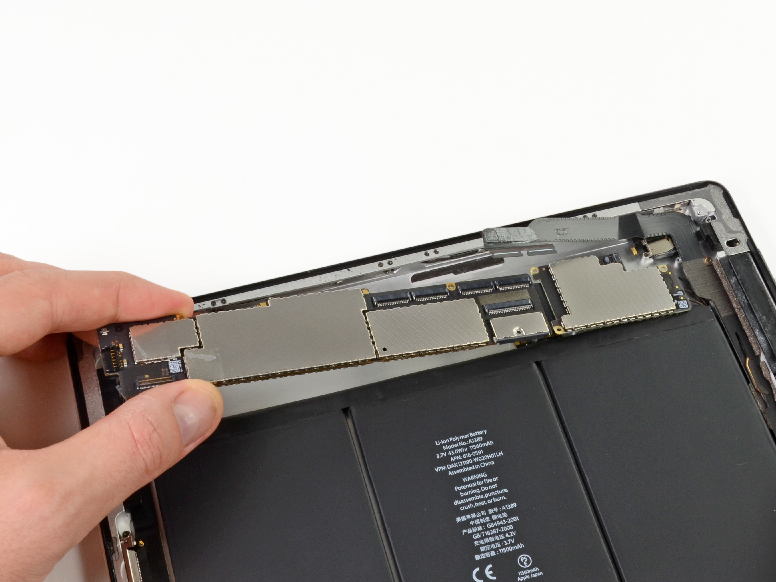

    • Using the tip of a spudger, peel back the piece of tape that secures the touchscreen ribbon cable to the logic board.
  34. iPad 3 4G Logic Board Replacement: step 34, image 1 of 3 iPad 3 4G Logic Board Replacement: step 34, image 2 of 3 iPad 3 4G Logic Board Replacement: step 34, image 3 of 3
    • Flip up the retaining flap on both of the touchscreen ribbon cable ZIF connectors.
  35. iPad 3 4G Logic Board Replacement: step 35, image 1 of 2 iPad 3 4G Logic Board Replacement: step 35, image 2 of 2
    • Use the flat end of a spudger to loosen the adhesive underneath the digitizer ribbon cable.
    • Pull the digitizer ribbon cable straight out of its sockets on the logic board.

  44. iPad 3 4G Logic Board Replacement: step 44, image 1 of 2 iPad 3 4G Logic Board Replacement: step 44, image 2 of 2
    • Holding the logic board by the side nearest the dock connector, carefully pull the logic board toward the bottom of the iPad.
