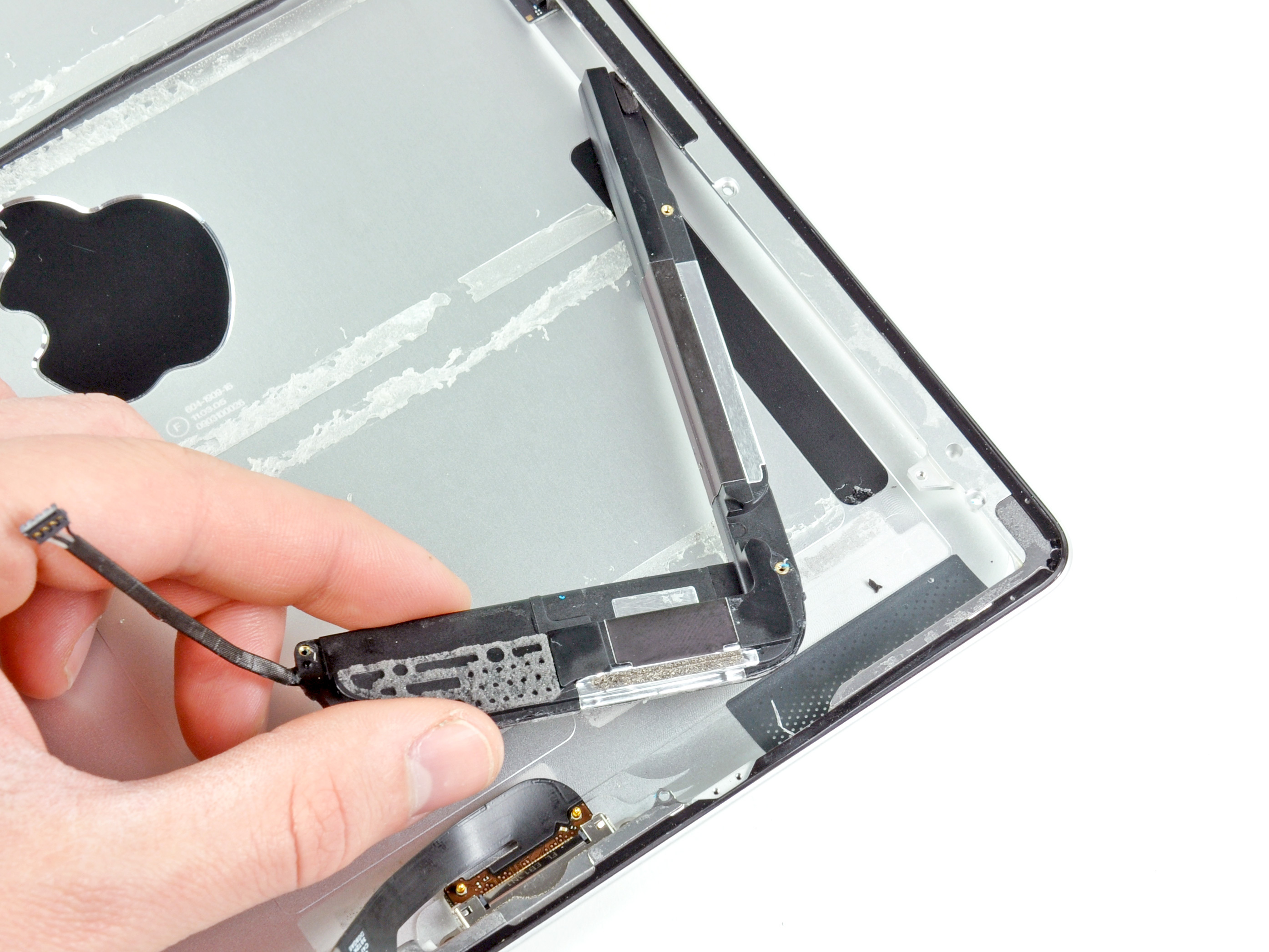

  58. iPad 2 Wi-Fi EMC 2415 Speaker Assembly Replacement: step 58, image 1 of 2 iPad 2 Wi-Fi EMC 2415 Speaker Assembly Replacement: step 58, image 2 of 2
    • Use the edge of a plastic opening tool to help push the speaker assembly out from under the right side of the rear panel.
    • Remove the speaker assembly from the iPad 2.
To reassemble your device, follow these directions in reverse and use our iPad 2 Wi-Fi Front Panel Adhesive strips guide to reattach the front panel.
