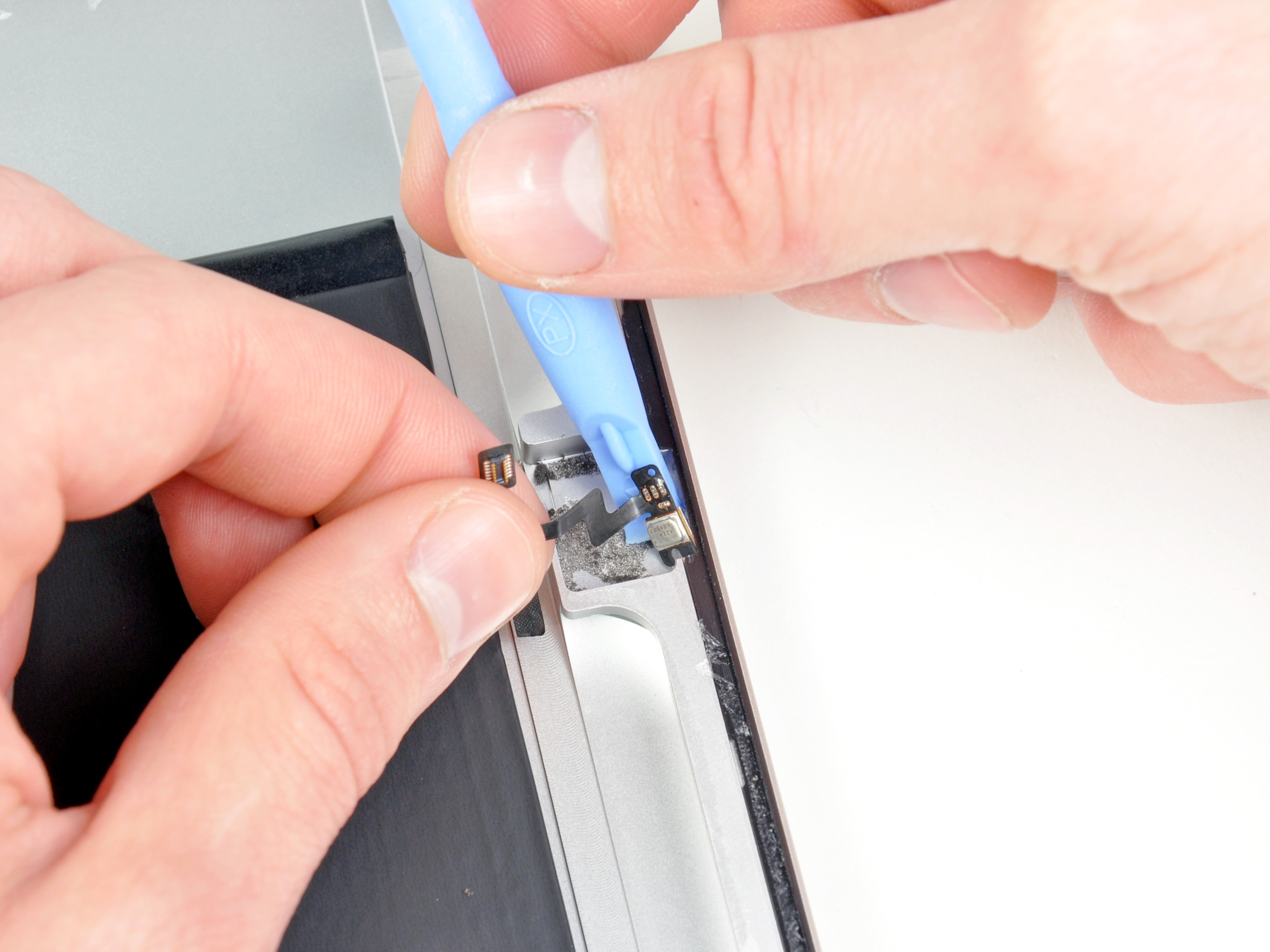

Add Note Edit Step 23  ¶
  • Using the guitar pick that is still underneath the bottom edge of the iPad, release the adhesive along the bottom left corner.
  • The bottom of the digitizer cable is only ~1" from the bottom of the iPad. Work carefully and slowly, making sure to not sever this cable.
Image #1 Image #2
Add Note Edit Step 24  ¶
  • Using one of the guitar picks, pry up the bottom right corner of the iPad and grab it with your fingers.
  • Some of the adhesive along the perimeter of the iPad may have stuck back down again. If this is the case, slide a guitar pick underneath the edge of the iPad where the front glass is still stuck and "cut" the adhesive.
