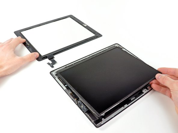

  • Holding the iPad by the top and bottom right corners, rotate the front glass away from the iPad.
  • Be careful of any adhesive that may still be attached, and use a guitar pick to cut any adhesive that may still be holding the front panel down.

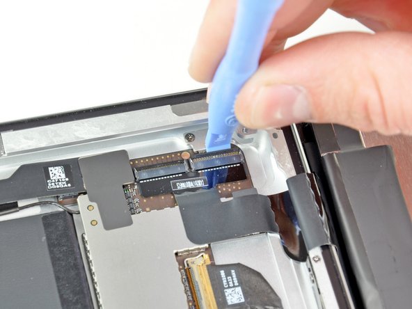

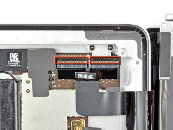

Add Note Edit Step 28 — Front Panel Assembly  ¶
  • Use the edge of a plastic opening tool to carefully flip up the retaining flaps on the two digitizer ribbon cable ZIF sockets.
  • Be sure you are prying up on the hinged retaining flaps, not the sockets themselves.
  • The retaining flaps are highlighted in red in the second picture.

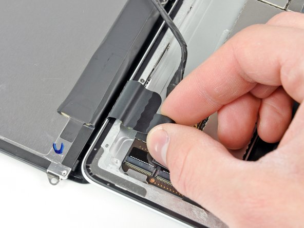

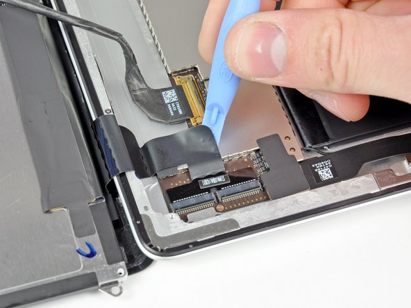

Add Note Edit Step 29  ¶
  • Use the edge of a plastic opening tool to peel the digitizer cable off the shields on the logic board.
  • Carefully pull the digitizer cable off the adhesive securing it to the side of the rear case.
Image #1
Add Note Edit Step 30  ¶
  • Pull the digitizer ribbon cable straight out of its two sockets on the logic board.

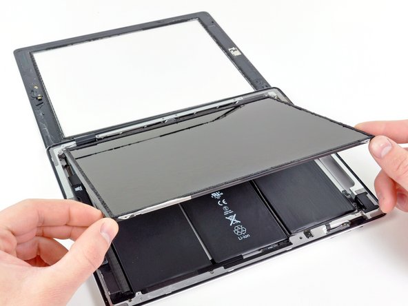

Add Note Edit Step 31  ¶
  • In order to remove the front panel assembly, the ribbon cable needs to slide out between the case and the LCD. You'll need to move the LCD to make some room.
    • Be very careful when moving the LCD, and do not attempt to remove it from the iPad—its cable will remain connected while it is rotated over.
  • Lift the LCD from its long edge farthest from the digitizer cable and gently flip it toward the rear case—like closing a book.
  • While holding the LCD up, gently slide the front panel away from the iPad. Be careful not to snag the digitizer cable on the rear case or LCD.
    • Set the LCD back into the body for safekeeping.

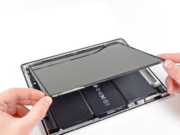

Add Note Edit Step 32 — LCD Assembly  ¶
  • In order to work on the iPad's innards, we need to flip the LCD back out of the case.
  • Lift the LCD from its long edge closest to the volume buttons and gently flip it out of the rear case—like turning the page in a book.
  • Set the LCD face down on a clean surface. You may want to rest it on a soft cloth to prevent scratches.
