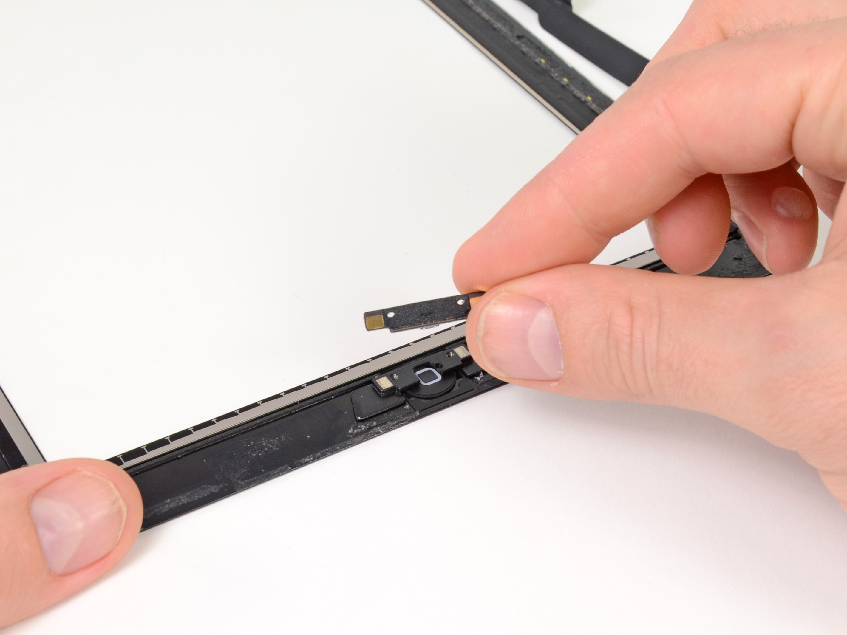

  30. iPad 2 Wi-Fi EMC 2415 Home Button Control Board Replacement, Front Panel Assembly: step 30, image 1 of 2 iPad 2 Wi-Fi EMC 2415 Home Button Control Board Replacement, Front Panel Assembly: step 30, image 2 of 2
    • Use the edge of a plastic opening tool to carefully flip up the retaining flaps on the two digitizer ribbon cable ZIF sockets.
    • Be sure you are prying up on the hinged retaining flaps, not the sockets themselves.
    • The retaining flaps are highlighted in red in the second picture.
  31. iPad 2 Wi-Fi EMC 2415 Home Button Control Board Replacement: step 31, image 1 of 2 iPad 2 Wi-Fi EMC 2415 Home Button Control Board Replacement: step 31, image 2 of 2
    • Use the edge of a plastic opening tool to peel the digitizer cable off the shields on the logic board.
    • Carefully pull the digitizer cable off the adhesive securing it to the side of the rear case.
  32. iPad 2 Wi-Fi EMC 2415 Home Button Control Board Replacement: step 32, image 1 of 1
    • Pull the digitizer ribbon cable straight out of its two sockets on the logic board.
  33. iPad 2 Wi-Fi EMC 2415 Home Button Control Board Replacement: step 33, image 1 of 2 iPad 2 Wi-Fi EMC 2415 Home Button Control Board Replacement: step 33, image 2 of 2
    • In order to remove the front panel assembly, the ribbon cable needs to slide out between the case and the LCD. You'll need to move the LCD to make some room.
    • Be very careful when moving the LCD, and do not attempt to remove it from the iPad—its cable will remain connected while it is rotated over.

  34. iPad 2 Wi-Fi EMC 2415 Home Button Control Board Replacement, Home Button Control Board: step 34, image 1 of 1
    • Remove the two 2.1 mm Phillips #00 screws securing the home button control board to the home button assembly.
  35. iPad 2 Wi-Fi EMC 2415 Home Button Control Board Replacement: step 35, image 1 of 2 iPad 2 Wi-Fi EMC 2415 Home Button Control Board Replacement: step 35, image 2 of 2
    • Use the tip of a spudger to gently push the home button control board off its mounts on the front panel.
    • Lift and remove the home button control board away from the front panel assembly.
To reassemble your device, follow these directions in reverse and use our iPad 2 Wi-Fi Front Panel Adhesive strips guide to reattach the front panel.
