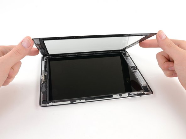

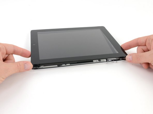

  • Holding the iPad by the top and bottom right corners, rotate the front glass away from the iPad.
  • Be careful of any adhesive that may still be attached, and use a guitar pick to cut any adhesive that may still be holding the front panel down.

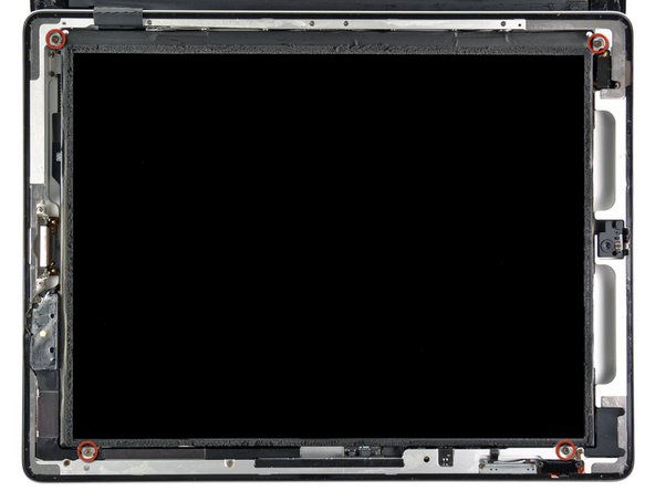

  • Remove the four 2.0 mm Phillips screws securing the LCD to the rear case.

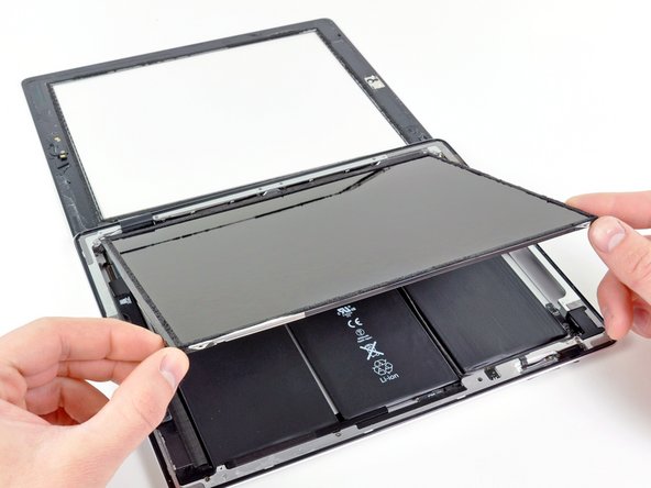

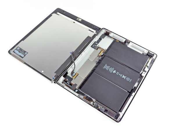

  • The front panel ribbon cables are connected beneath the LCD. To access them, you'll need to temporarily flip the LCD over and out of the way.
    • Be very careful when moving the LCD, and do not attempt to remove it from the iPad—its display data cable will remain connected while it is rotated over.
  • Lift the LCD from its long edge closest to the volume buttons and gently flip it out of the rear case—like turning the page in a book.
  • Set the LCD face down on the front panel.

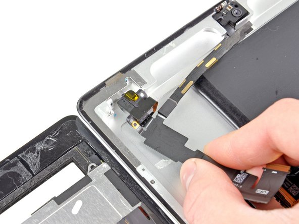

Add Note Edit Step 28 — Heaphone Jack & Front Camera Assembly  ¶

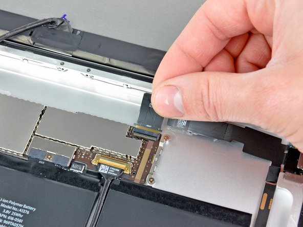

  • Use the flat end of a plastic opening tool to flip up the retaining flap on the headphone jack and front-facing camera ribbon cable ZIF socket.
  • Run a plastic opening tool underneath the headphone jack and front-facing camera cable to free it from the adhesive attaching the cable to the rear panel.
  • Pull the headphone jack and front-facing camera ribbon cable straight out of its socket on the logic board.

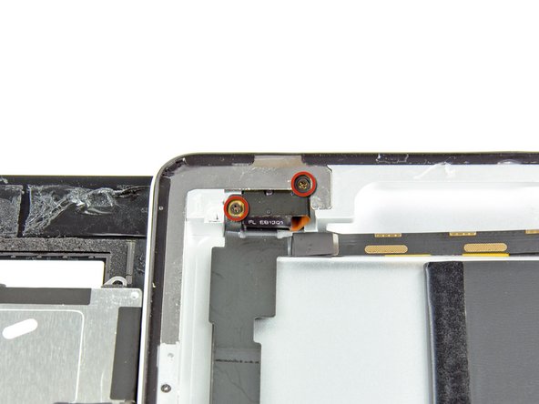

Add Note Edit Step 29  ¶
  • Remove the two 2.9 mm Phillips screws securing the headphone jack to the rear panel.

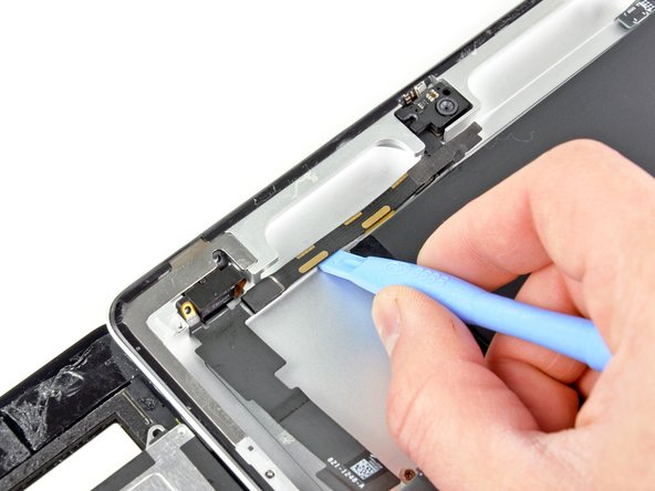

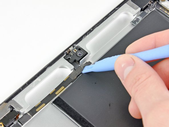

Image #1 Image #2

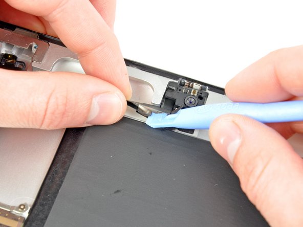

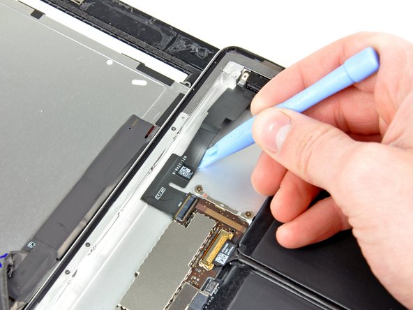

Add Note Edit Step 30  ¶
  • Use the edge of a plastic opening tool to peel the tape and the adhesive securing the headphone jack & front camera cables to the rear panel.
Image #1
Add Note Edit Step 31  ¶
  • Pull the headphone jack away from the top edge of the iPad.
  • Don't try to remove the assembly just yet. The front camera is still stuck to the rear panel.

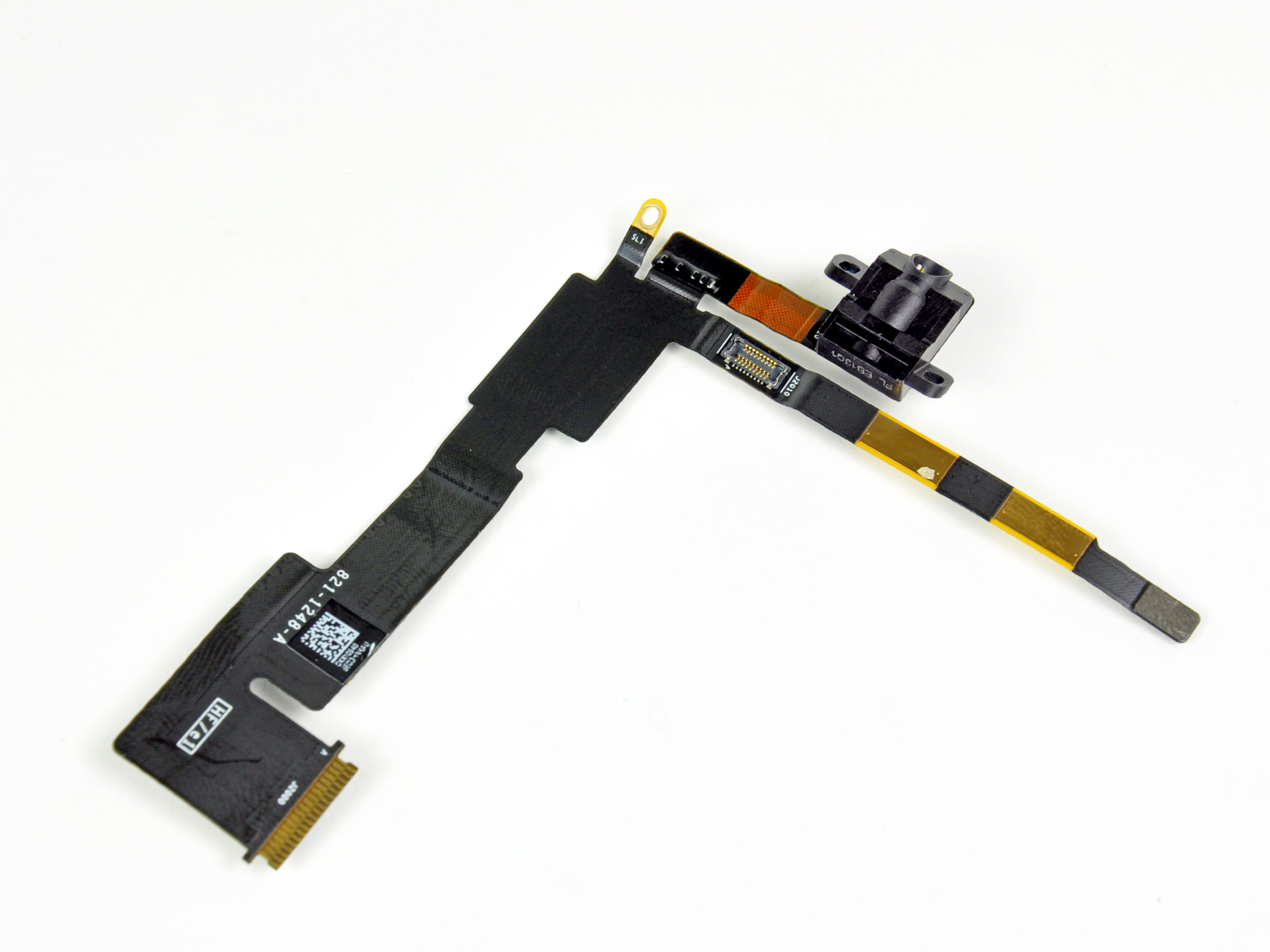

Image #1
Add Note Edit Step 32  ¶
  • Lift the headphone jack & front camera cables slightly to access the microphone connector.
  • Use the edge of a plastic opening tool to separate the microphone connector from its socket on the headphone jack & front camera cables.
