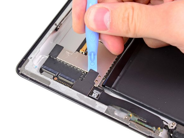

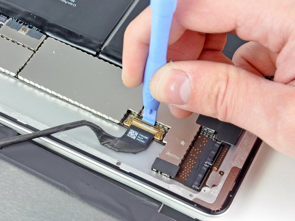

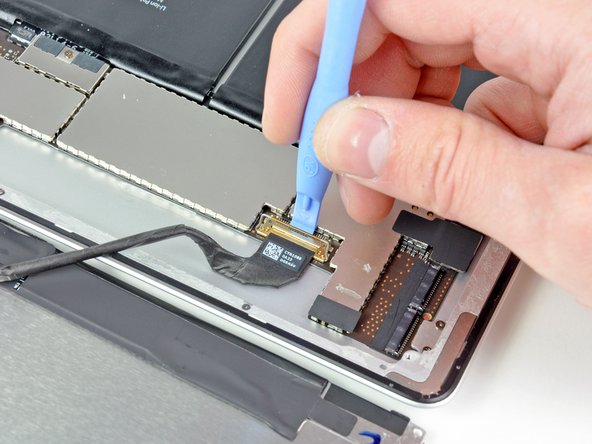

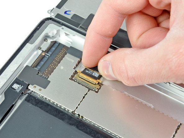

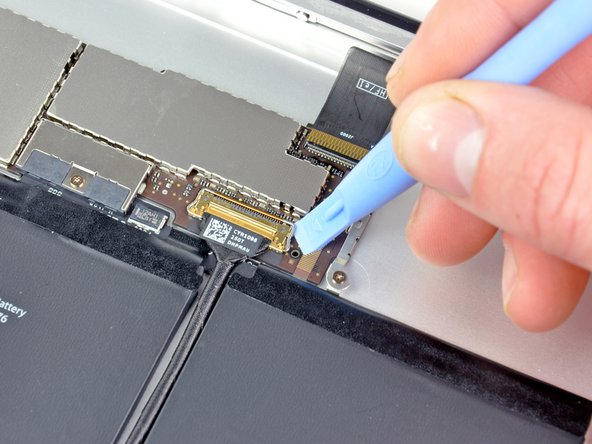

Add Note Edit Step 33 — Logic Board  ¶
  • Use a plastic opening tool to lift the display data cable lock upwards.
  • Pull the display data cable out of its socket.
  • Be careful not pull the connector upward as you disconnect it from its socket.

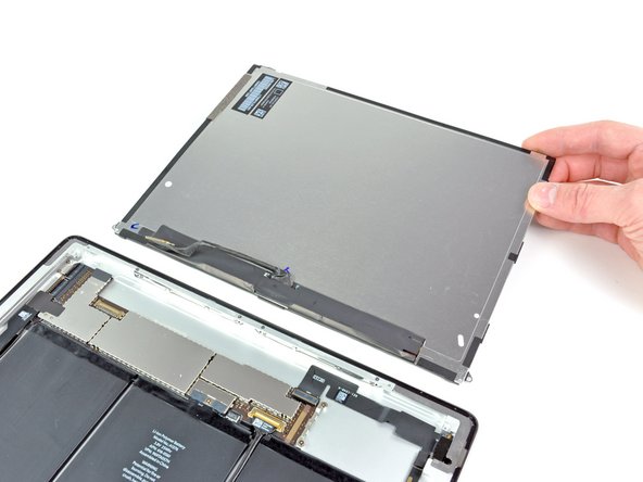

Add Note Edit Step 34  ¶
  • Remove the LCD assembly from the rear panel assembly.

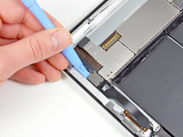

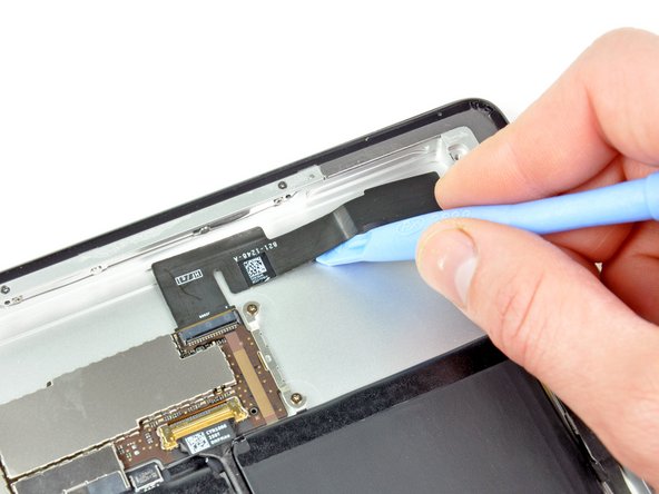

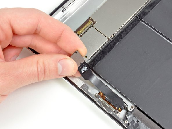

Add Note Edit Step 35  ¶
  • If present, use a plastic opening tool to help remove the piece of tape covering the end of the dock connector cable.
  • Use the edge of a plastic opening tool to carefully pry the dock connector cable's connector up from its socket on the logic board.
  • Peel the dock connector ribbon cable off the rear panel.

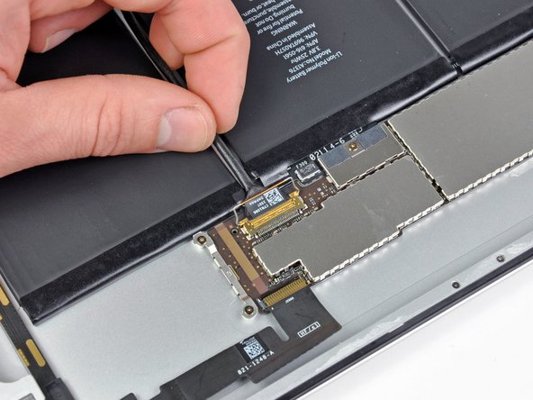

Add Note Edit Step 36  ¶
  • Pry the speaker cable connector straight up from its socket on the logic board.
  • Be careful to pry only the connector, not the socket on the logic board, or you may destroy the socket.

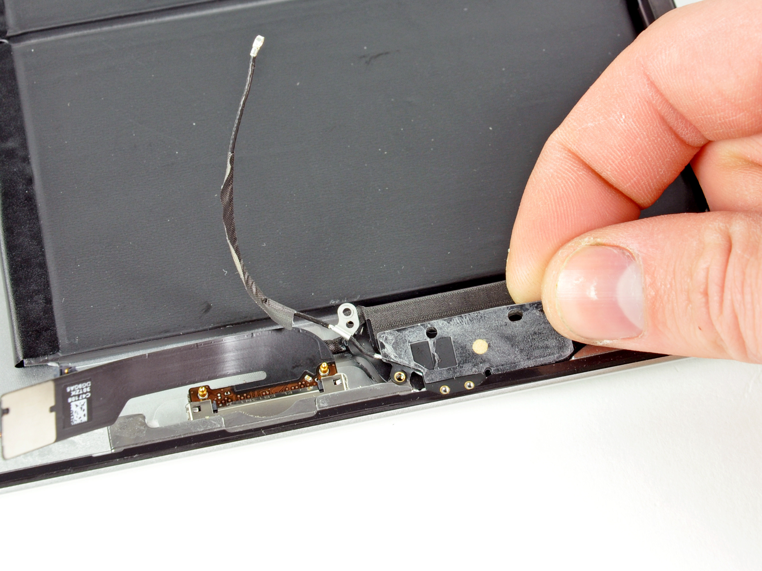

Add Note Edit Step 37  ¶
  • Use the edge of a plastic opening tool to flip up the retaining flap on the headphone jack and front camera cable ZIF socket.
  • Be sure you are prying upward on the hinged retaining flap, not the socket itself.
  • Peel the headphone jack and front camera cable off the rear case.

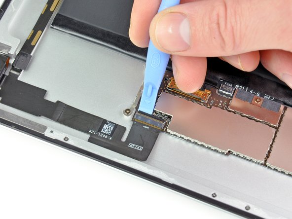

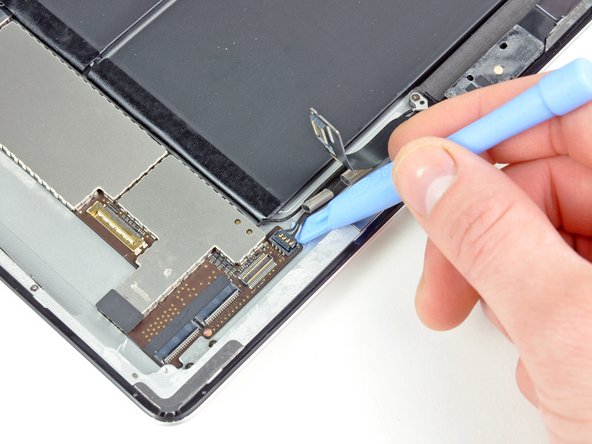

Add Note Edit Step 39  ¶
  • Use the edge of a plastic opening tool to flip up the retainer securing the control board cable connector to its socket on the logic board.
  • Pull the connector away from its socket on the logic board.
  • Do not lift the cable upward as you disconnect it.

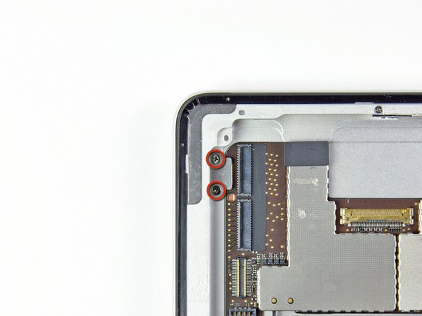

Add Note Edit Step 40  ¶
  • Remove the two 2.1 mm Phillips screws securing the logic board bracket to the rear case near the digitizer cable socket.
  • Remove the logic board bracket from the rear case.
