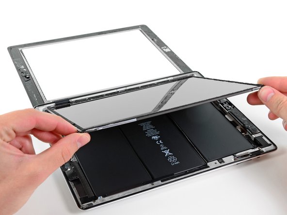

Add Note Edit Step 25  ¶
  • Holding the iPad by the top and bottom right corners, rotate the front glass away from the iPad.
  • Be careful of any adhesive that may still be attached, and use a guitar pick to cut any adhesive that may still be holding the front panel down.

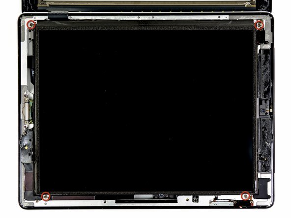

Add Note Edit Step 26 — LCD  ¶
  • Remove the four 2.0 mm Phillips #0 screws securing the LCD to the rear case.
Image #1 Image #2

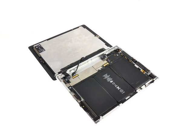

Add Note Edit Step 27  ¶
  • The front panel ribbon cables are connected beneath the LCD. To access them, you'll need to temporarily flip the LCD over and out of the way.
    • Be very careful when moving the LCD, and do not attempt to remove it from the iPad—its display data cable will remain connected while it is rotated over.
  • Lift the LCD from its long edge closest to the volume buttons and gently flip it out of the rear case—like turning the page in a book.
  • Set the LCD face down on the front panel.
