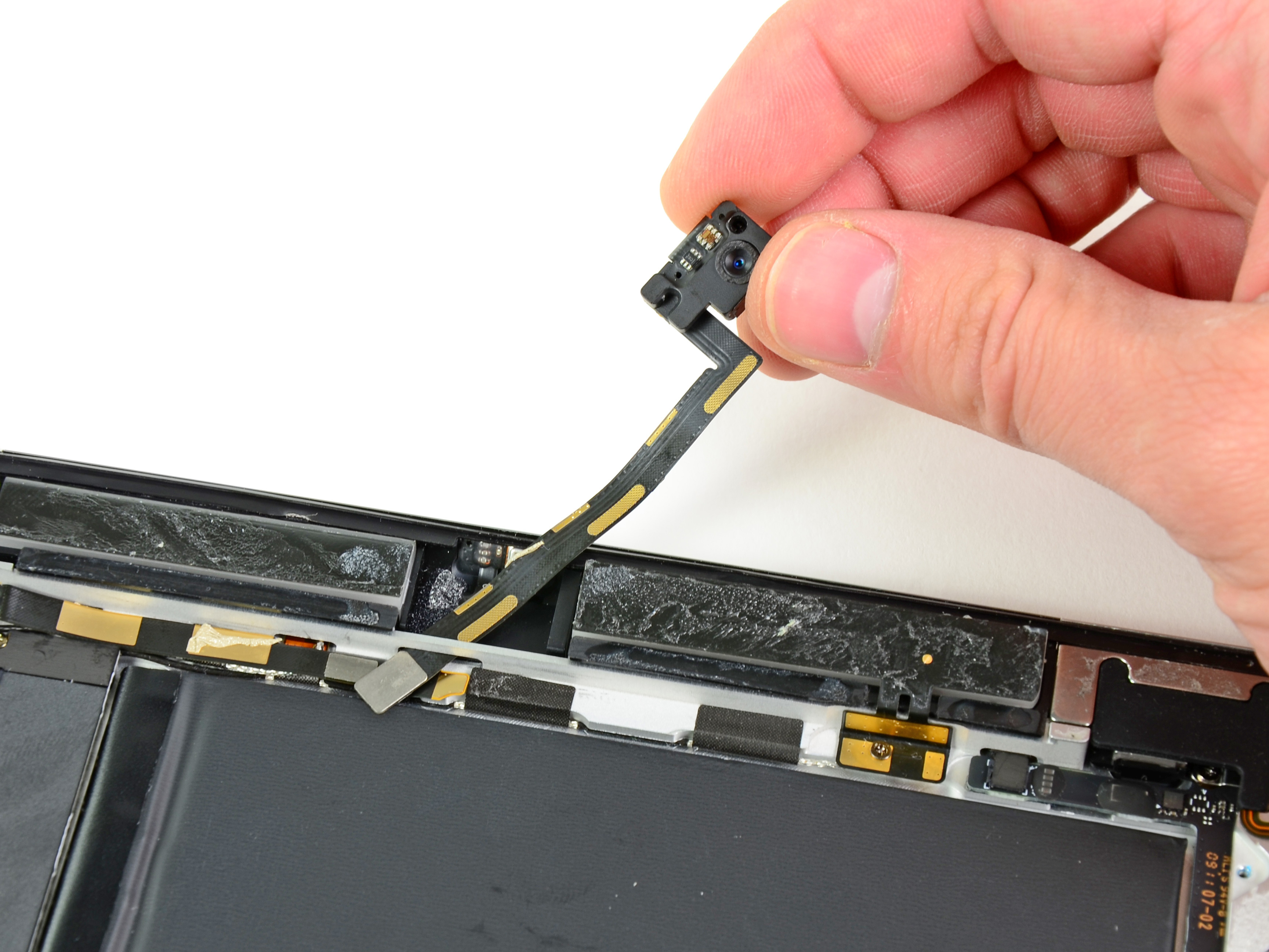

Installing iPad 2 CDMA Front Facing Camera
Replace the Front Facing Camera in your iPad 2 CDMA.
Use this guide to replace the front facing camera.

Add Note Edit Step 5  ¶
  • There is a small gap in the iPad's adhesive ring in the upper right corner of the iPad, approximately 2.0 inches (~5 cm) from the top of the iPad. You are going to exploit this weakness.
  • Insert the tip of a plastic opening tool into the gap between the front glass and the plastic bezel. Just insert the very tip of the opening tool, just enough to widen the crack.
  • It may require some force to get the wedged tip of the opening tool between the glass and plastic. Work patiently and carefully, wiggling the plastic opening tool back and forth as necessary.
Image #1 Image #2
Add Note Edit Step 6  ¶
  • Keeping the tip of the plastic opening tool wedged between the front glass and plastic bezel, slide a plastic guitar pick in the gap, right next to the plastic opening tool.
Image #1 Image #2
Add Note Edit Step 7  ¶
  • Remove the plastic opening tool from the iPad, and push the guitar pick further underneath the front glass to a depth of ~0.5 inches.
Image #1
