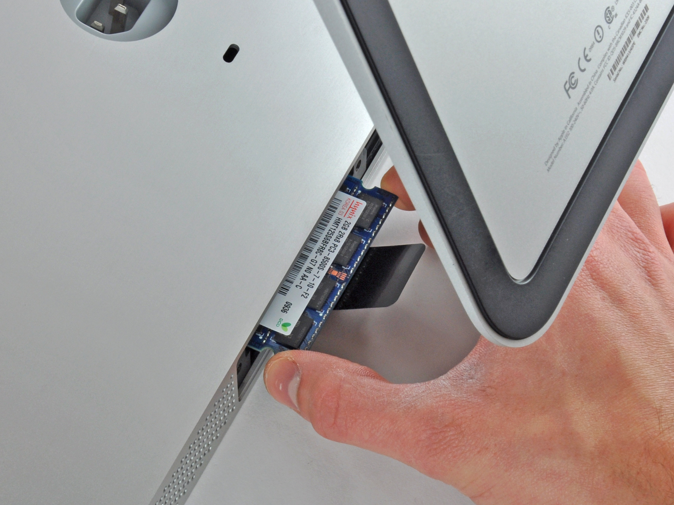

  2. iMac Intel 27" EMC 2429 RAM Replacement, RAM: step 2, image 1 of 1
    • Use your fingers or the tip of a spudger to slide the black plastic RAM tray pull tab out of the RAM slot.
  3. iMac Intel 27" EMC 2429 RAM Replacement: step 3, image 1 of 2 iMac Intel 27" EMC 2429 RAM Replacement: step 3, image 2 of 2
    • Pull the black plastic tab away from the iMac to eject the RAM chip from its socket.
    • The RAM modules are firmly seated and may require a fair amount of force to remove.
    • Use your fingers to slide the RAM chip out of its socket.
    • If necessary, repeat this process for the other RAM module(s).

My iMac 21.5-inch Mid 2011 has EMC 2428, but still directions turned out to be the same.
I replaced the memory in my MacBook Pro, and used the old cards (2x2GB) to fill out the 2 empty slots that apple left empty, doubled the memory of 2 machines for the price of one ^_^
Mabel - Reply
So confused. I have an end 2429 and I ordered some memory hut its says notebook memory, do these machines use the same type of ram?
Kosta Kritikos -
Thanks ifixit team, I did it. It is really piece of cake! Thanks again!
prelude0214 - Reply
What's the real max capacity for the RAM?
Angel Pimienta - Reply
16 Gb (4 x 4 Gb) DDR3 1333 MHz
