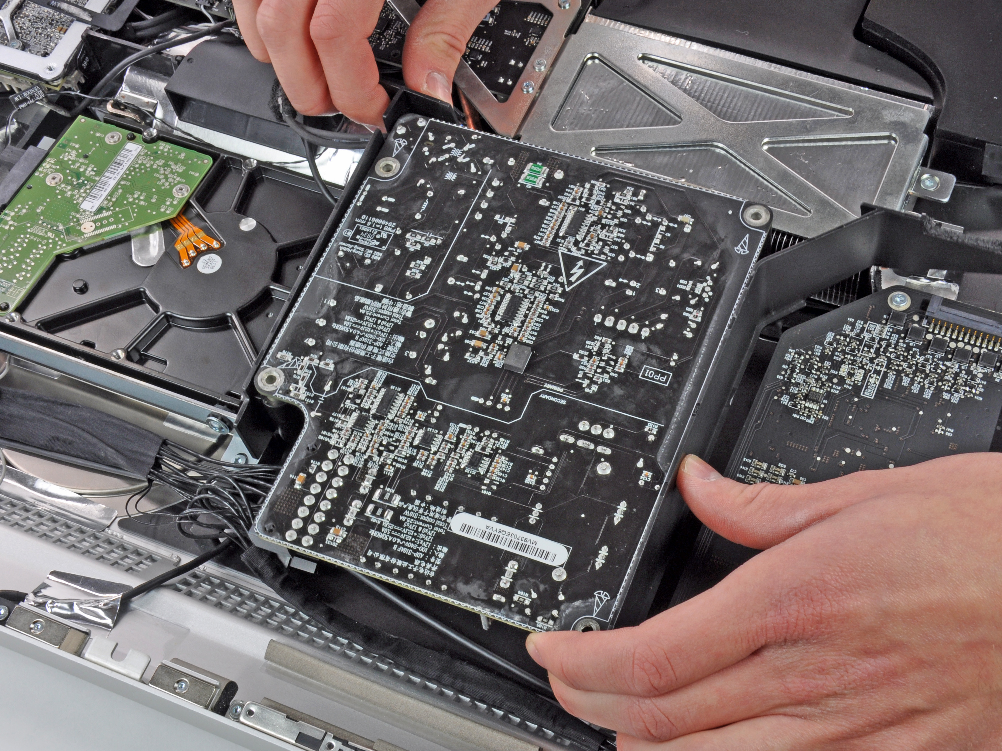

Installing iMac Intel 27" EMC 2429 Power Supply
Replace the power supply in an iMac Intel 27" EMC 2429.

This guide will help you replace the power supply.

Add Note Edit Step 1 — Glass Panel  ¶
  • Stick a suction cup near each of the two top corners of the glass panel.
  • To attach the suction cups we sell, first position the suction cup with the movable handle parallel to the face of the glass panel (as highlighted in the first and second pictures).
  • While lightly holding the suction cup against the glass, raise the movable handle until it is parallel with the other handle (as highlighted by the third picture).
  • If your suction cups refuse to stick, try cleaning both the glass panel and the suction cup with a mild solvent.
Image #1 Image #2 Image #3
Add Note Edit Step 2  ¶
  • Gently lift the glass panel perpendicular to the face of the LCD enough to clear the steel mounting pins attached along the underside of the top edge of the glass panel.
  • Pull the glass panel away from the lower edge of the iMac and carefully set it aside.
  • During reinstallation, be sure to meticulously clean the inside of the glass panel and the face of the LCD as any dust or fingerprints trapped inside will be annoyingly visible when the machine is turned on.
Image #1
Add Note Edit Step 3 — Display  ¶
  • Remove the eight T10 Torx screws securing the LCD to the outer case.
Add Note Edit Step 4  ¶
  • Carefully lay the iMac stand-side down on a flat surface.
  • Due to tight tolerances, you will have to use a thin hooked tool to lift the display out of the outer case. As seen in the first picture, we made one out of a bent paperclip.
    • Alternatively, our Dual Hard Drive Kit includes a pair of tweezers with an angled tip that are great for this task.
  • Use a thin hooked tool to lift one side of the top edge of the display by its steel outer frame.
  • After lifting the top edge of the display on one side, hold it out of the outer case while you use a hooked tool to lift the other side.
  • Raise and hold the display high enough to access the cables.
  • Do not lift the top edge of the display out of the outer case too far, as several short ribbon cables still connect the two components.
Image #1
Add Note Edit Step 5  ¶
  • Disconnect the vertical sync cable in the upper left corner of the screen. Use the tip of a spudger to push on the connector's side tabs.
Image #1
Add Note Edit Step 6  ¶
  • Disconnect the LED back light driver cable with your hand by pressing the tab down and sliding it towards the bottom of the display.
Image #1 Image #2
Add Note Edit Step 7  ¶
  • Pull the black tab straight up to disconnect the latch on the display data cable ZIF connector.
  • Do not pull up too hard or you will damage the connector and socket.
  • Continue to pull the black tab up toward the top of the device, to detach the display data cable.
Image #1
Add Note Edit Step 8  ¶
  • Use the tip of a spudger to disconnect the display power cable next to the display data cable.
