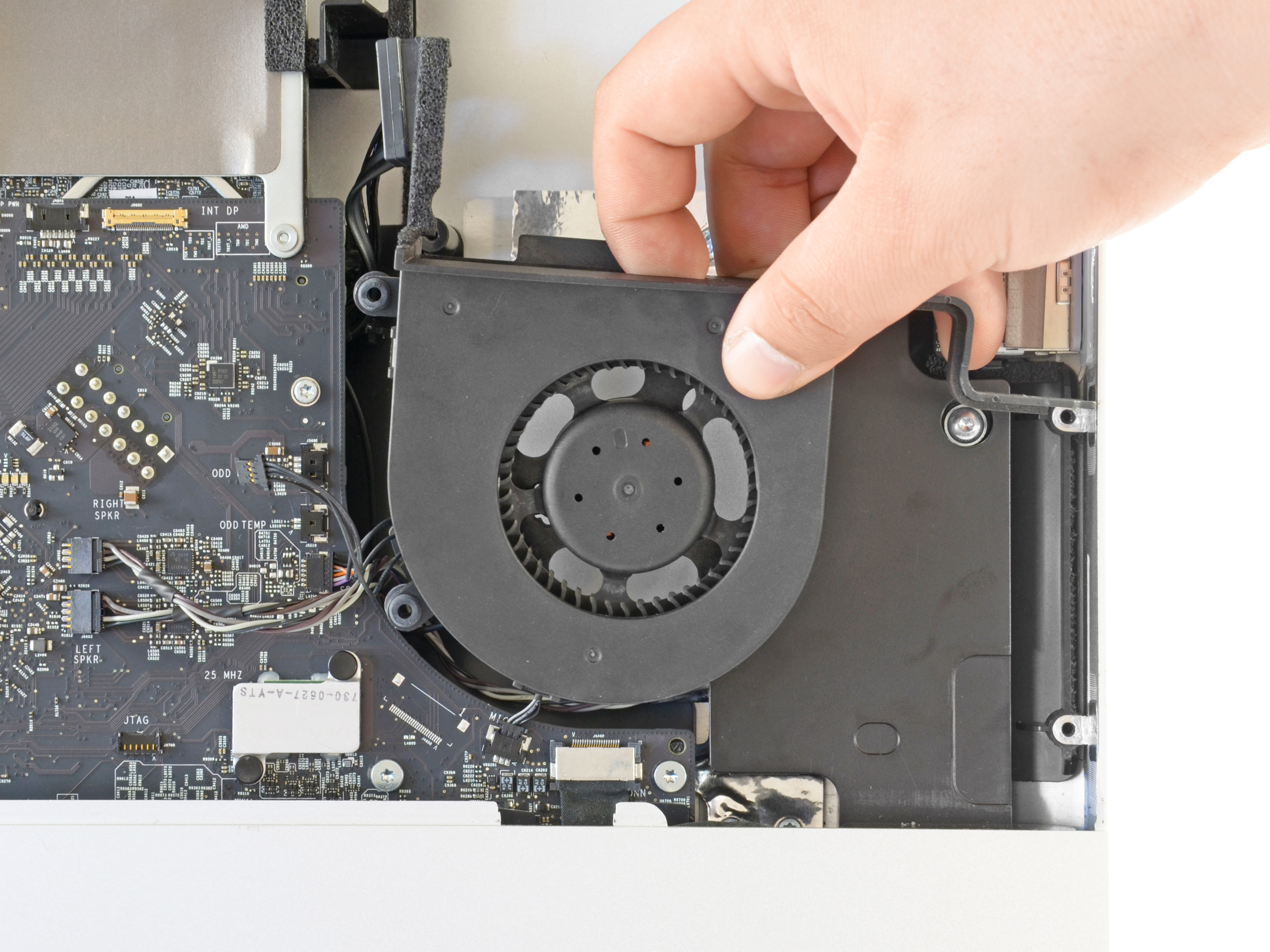

Installing iMac Intel 27" EMC 2429 Optical Drive Fan
Replace the optical drive fan in an iMac Intel 27" EMC 2429.
This guide will help you replace the optical drive fan.
