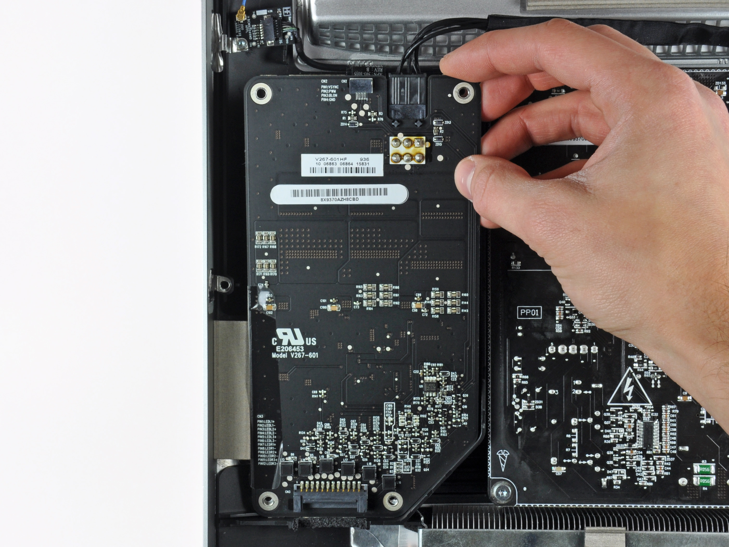

Installing iMac Intel 27" EMC 2429 LED Driver Board
Replace the LED driver board in an iMac Intel 27" EMC 2429.
This guide will help you replace the LED driver board.

Add Note Edit Step 3 — Display  ¶
  • Remove the eight T10 Torx screws securing the LCD to the outer case.
Image #1 Image #2 Image #3
Add Note Edit Step 4  ¶
  • Carefully lay the iMac stand-side down on a flat surface.
  • Due to tight tolerances, you will have to use a thin hooked tool to lift the display out of the outer case. As seen in the first picture, we made one out of a bent paperclip.
    • Alternatively, our Dual Hard Drive Kit includes a pair of tweezers with an angled tip that are great for this task.
  • Use a thin hooked tool to lift one side of the top edge of the display by its steel outer frame.
  • After lifting the top edge of the display on one side, hold it out of the outer case while you use a hooked tool to lift the other side.
  • Raise and hold the display high enough to access the cables.
  • Do not lift the top edge of the display out of the outer case too far, as several short ribbon cables still connect the two components.
Image #1
Add Note Edit Step 5  ¶
  • Disconnect the vertical sync cable in the upper left corner of the screen. Use the tip of a spudger to push on the connector's side tabs.
Image #1
Add Note Edit Step 6  ¶
  • Disconnect the LED back light driver cable with your hand by pressing the tab down and sliding it towards the bottom of the display.
Image #1 Image #2
Add Note Edit Step 7  ¶
  • Pull the black tab straight up to disconnect the latch on the display data cable ZIF connector.
  • Do not pull up too hard or you will damage the connector and socket.
  • Continue to pull the black tab up toward the top of the device, to detach the display data cable.
Image #1
Add Note Edit Step 8  ¶
  • Use the tip of a spudger to disconnect the display power cable next to the display data cable.
Next » « Previous
