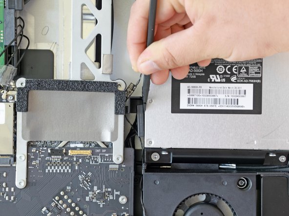

Add Note Edit Step 13 — Optical Drive  ¶
  • Use the flat end of a spudger to pull the optical drive data cable out of the optical drive.
Image #1

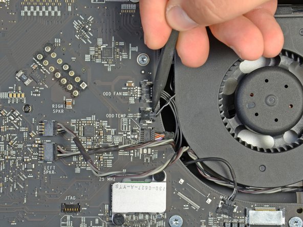

Add Note Edit Step 14  ¶
  • Use the tip of a spudger to pull the optical drive thermal sensor connector out of its socket.
Image #1

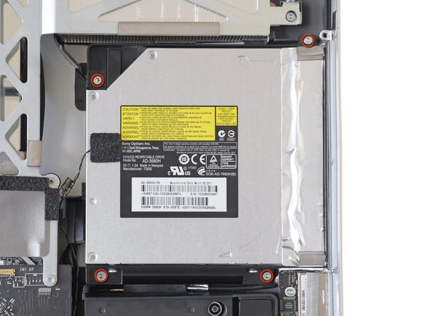

Add Note Edit Step 15  ¶
  • Remove the four T10 Torx screws securing the optical drive to the iMac case.
Image #1 Image #2

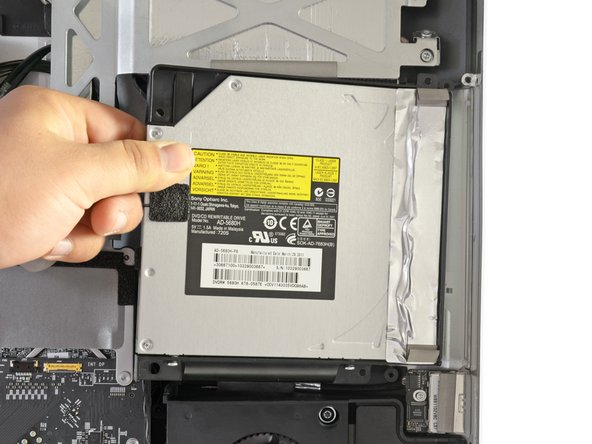

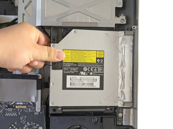

Add Note Edit Step 16  ¶
  • Slightly lift the left edge of the optical drive and then pull it to the side to release the centering pins.
  • Be careful not to rip the thermal sensor cable as you remove the optical drive.
