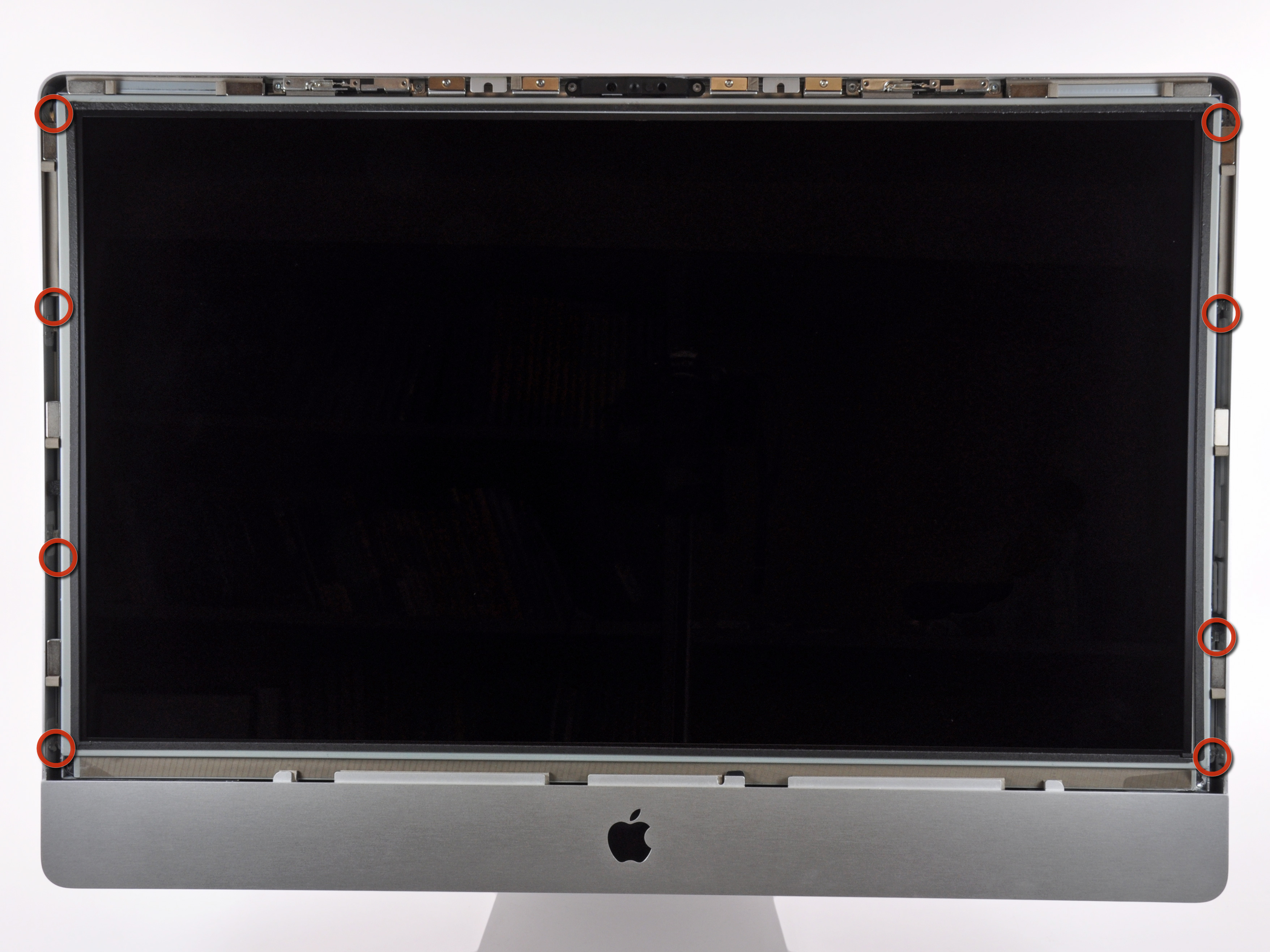

  3. iMac Intel 27" EMC 2429 Display Replacement, Display: step 3, image 1 of 1
    • Remove the eight T10 Torx screws securing the LCD to the outer case.
    • Be careful not to touch the display as the oil from your fingers may leave a residue that can be difficult to remove.
    • If necessary, peel the EMI gaskets located near the top center edge of the display assembly.
