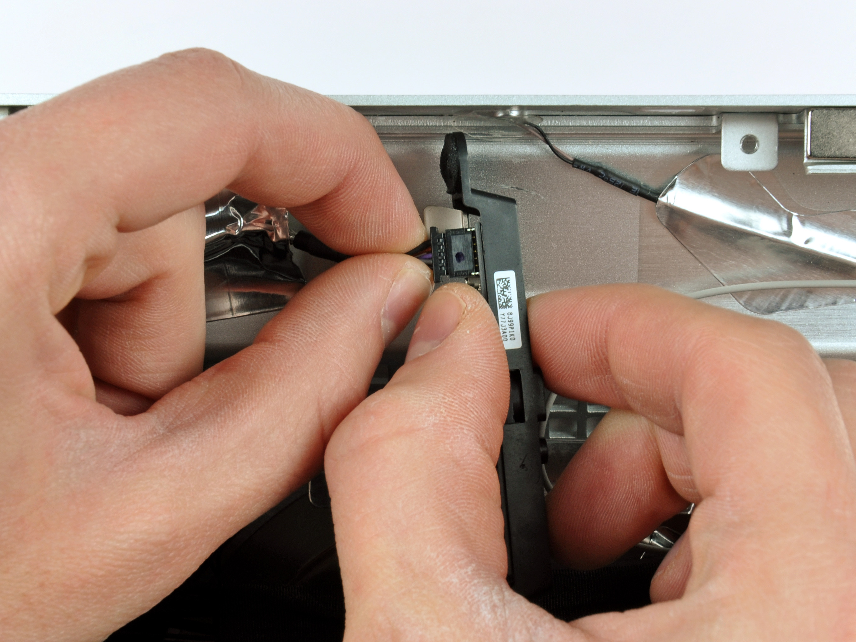

Replace the camera board in an iMac Intel 27" EMC 2429.
Use this guide to replace the camera board.
