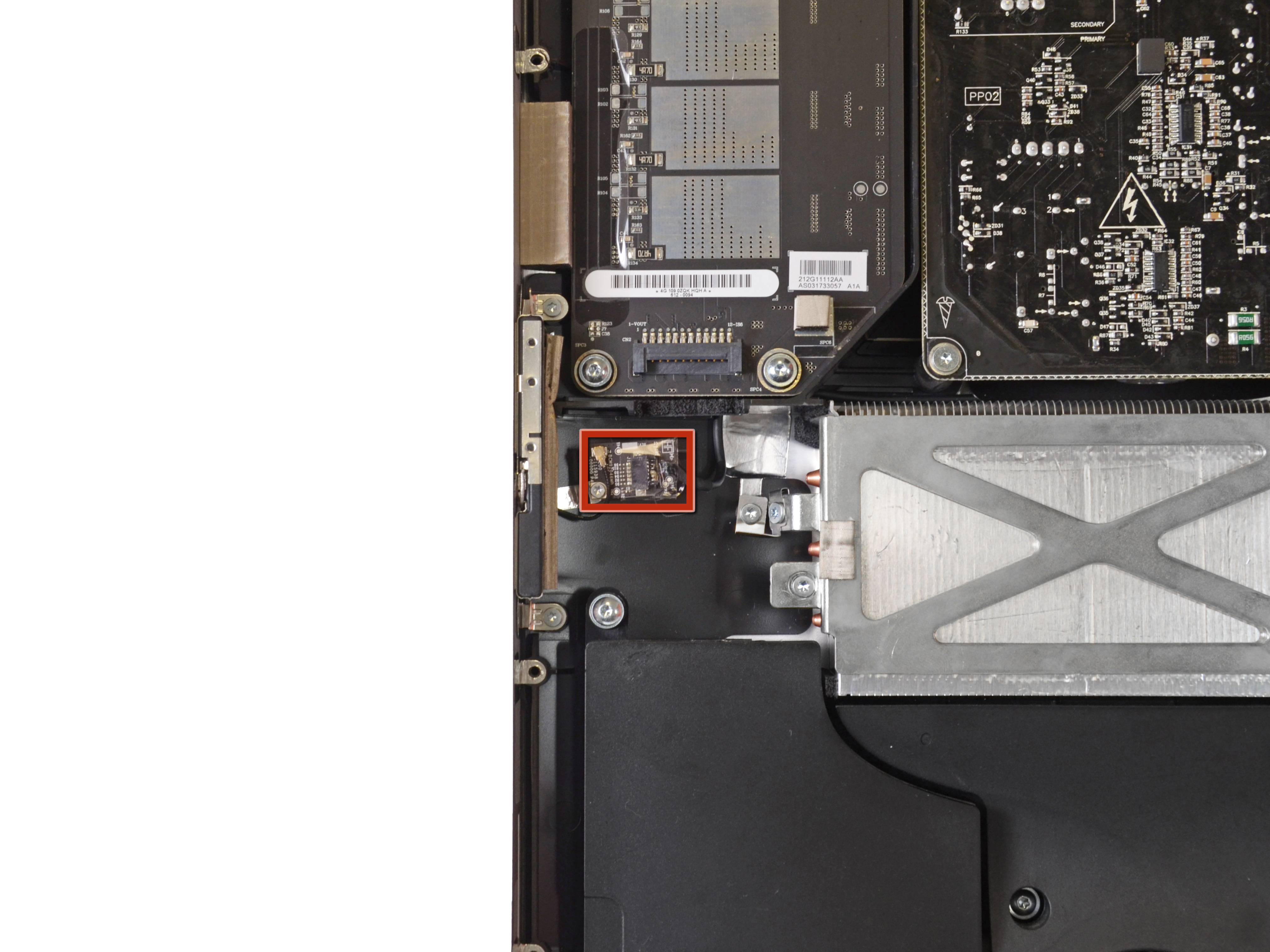

Installing iMac Intel 27" EMC 2429 Bluetooth Board
Replace the bluetooth board in an iMac Intel 27" EMC 2429.
Use this guide to replace the Bluetooth board.

  • Remove the eight T10 Torx screws securing the LCD to the outer case.
Image #1 Image #2 Image #3
Add Note Edit Step 4  ¶
  • Carefully lay the iMac stand-side down on a flat surface.
  • Due to tight tolerances, you will have to use a thin hooked tool to lift the display out of the outer case. As seen in the first picture, we made one out of a bent paperclip.
    • Alternatively, our Dual Hard Drive Kit includes a pair of tweezers with an angled tip that are great for this task.
  • Use a thin hooked tool to lift one side of the top edge of the display by its steel outer frame.
  • After lifting the top edge of the display on one side, hold it out of the outer case while you use a hooked tool to lift the other side.
  • Raise and hold the display high enough to access the cables.
  • Do not lift the top edge of the display out of the outer case too far, as several short ribbon cables still connect the two components.
