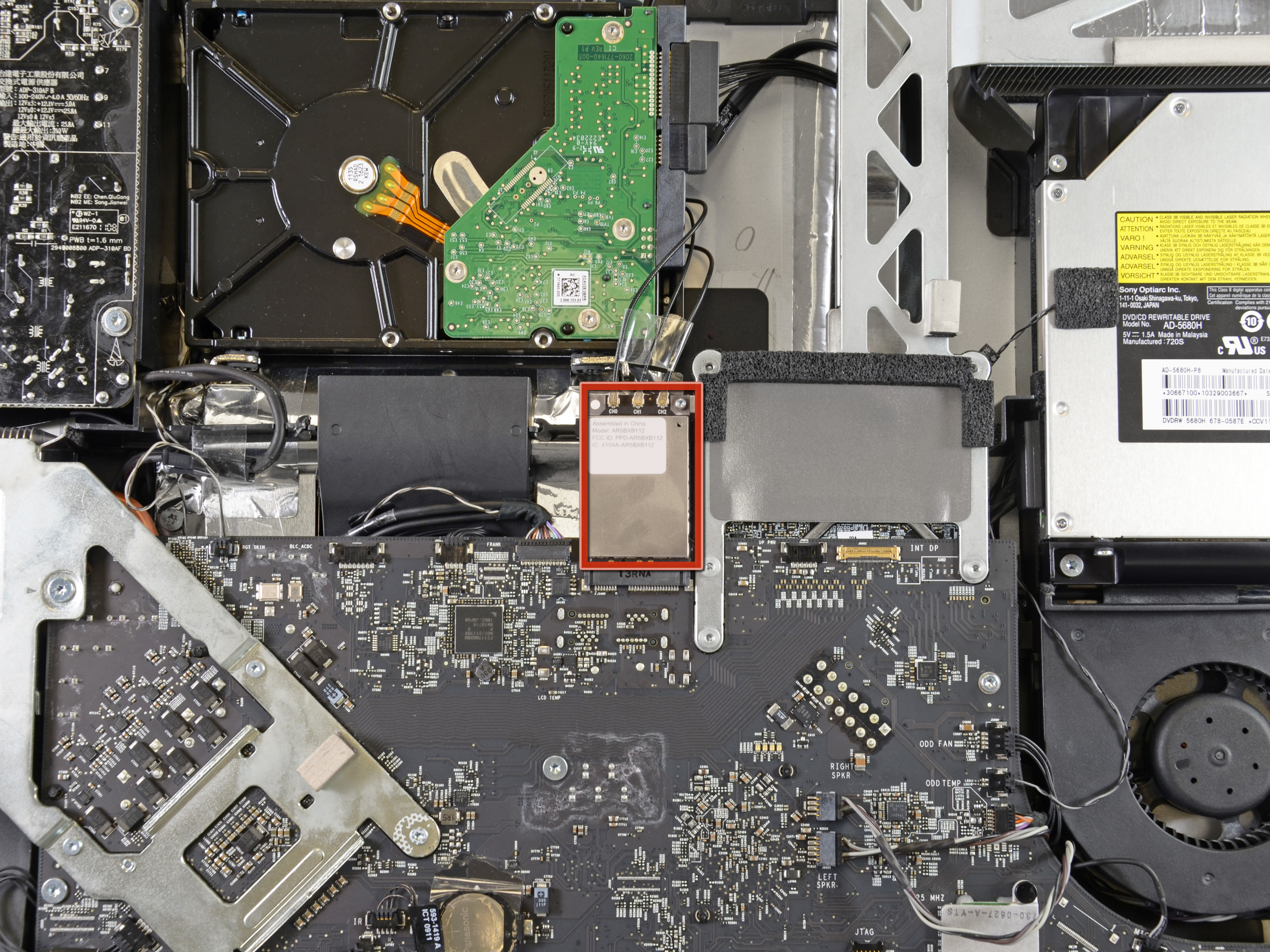

Installing iMac Intel 27" EMC 2429 AirPort Card
Replace the AirPort card in an iMac Intel EMC 2429.
Use this guide to replace the AirPort card.

Add Note Edit Step 3 — Display  ¶
  • Remove the eight T10 Torx screws securing the LCD to the outer case.
Image #1 Image #2 Image #3
Add Note Edit Step 4  ¶
  • Carefully lay the iMac stand-side down on a flat surface.
  • Due to tight tolerances, you will have to use a thin hooked tool to lift the display out of the outer case. As seen in the first picture, we made one out of a bent paperclip.
    • Alternatively, our Dual Hard Drive Kit includes a pair of tweezers with an angled tip that are great for this task.
  • Use a thin hooked tool to lift one side of the top edge of the display by its steel outer frame.
  • After lifting the top edge of the display on one side, hold it out of the outer case while you use a hooked tool to lift the other side.
  • Raise and hold the display high enough to access the cables.
  • Do not lift the top edge of the display out of the outer case too far, as several short ribbon cables still connect the two components.
Image #1
Add Note Edit Step 5  ¶
  • Disconnect the vertical sync cable in the upper left corner of the screen. Use the tip of a spudger to push on the connector's side tabs.
Image #1
Add Note Edit Step 6  ¶
  • Disconnect the LED back light driver cable with your hand by pressing the tab down and sliding it towards the bottom of the display.
Image #1 Image #2
Add Note Edit Step 7  ¶
  • Pull the black tab straight up to disconnect the latch on the display data cable ZIF connector.
  • Do not pull up too hard or you will damage the connector and socket.
  • Continue to pull the black tab up toward the top of the device, to detach the display data cable.
Image #1
Add Note Edit Step 8  ¶
  • Use the tip of a spudger to disconnect the display power cable next to the display data cable.
Next » « Previous
