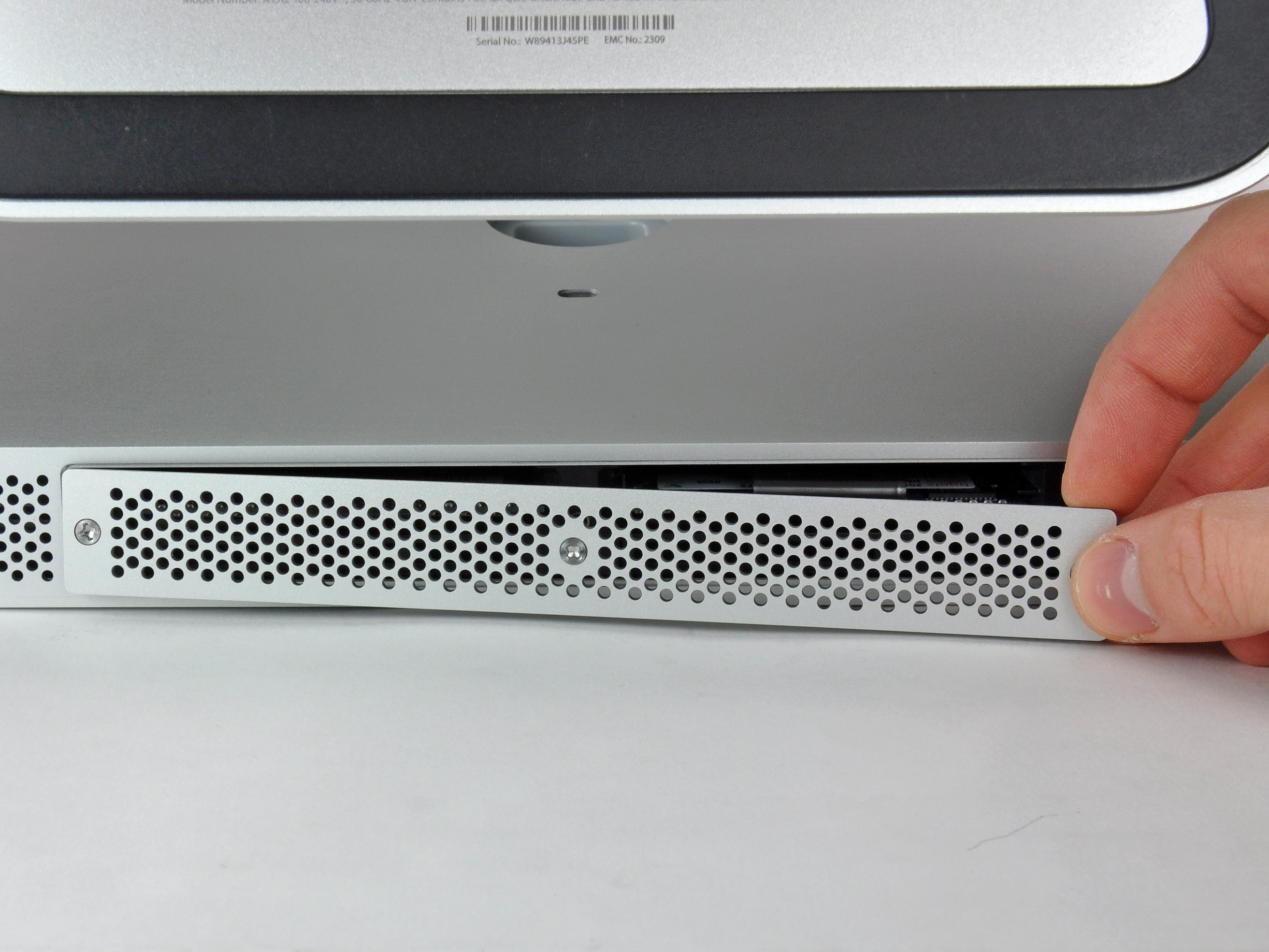

Remove the access door to replace it or access the RAM.
Image #1 Image #2
Add Note Edit Step 1 — Access Door  ¶
  • Loosen the three Phillips screws securing the access door to the bottom edge of your iMac.
  • These screws will remain captive in the access door.
  • Remove the access door from your iMac.
  • During reassembly, fasten the access door loosely and align it with the pocket cut into the outer case of the iMac before fully tightening the screws.
