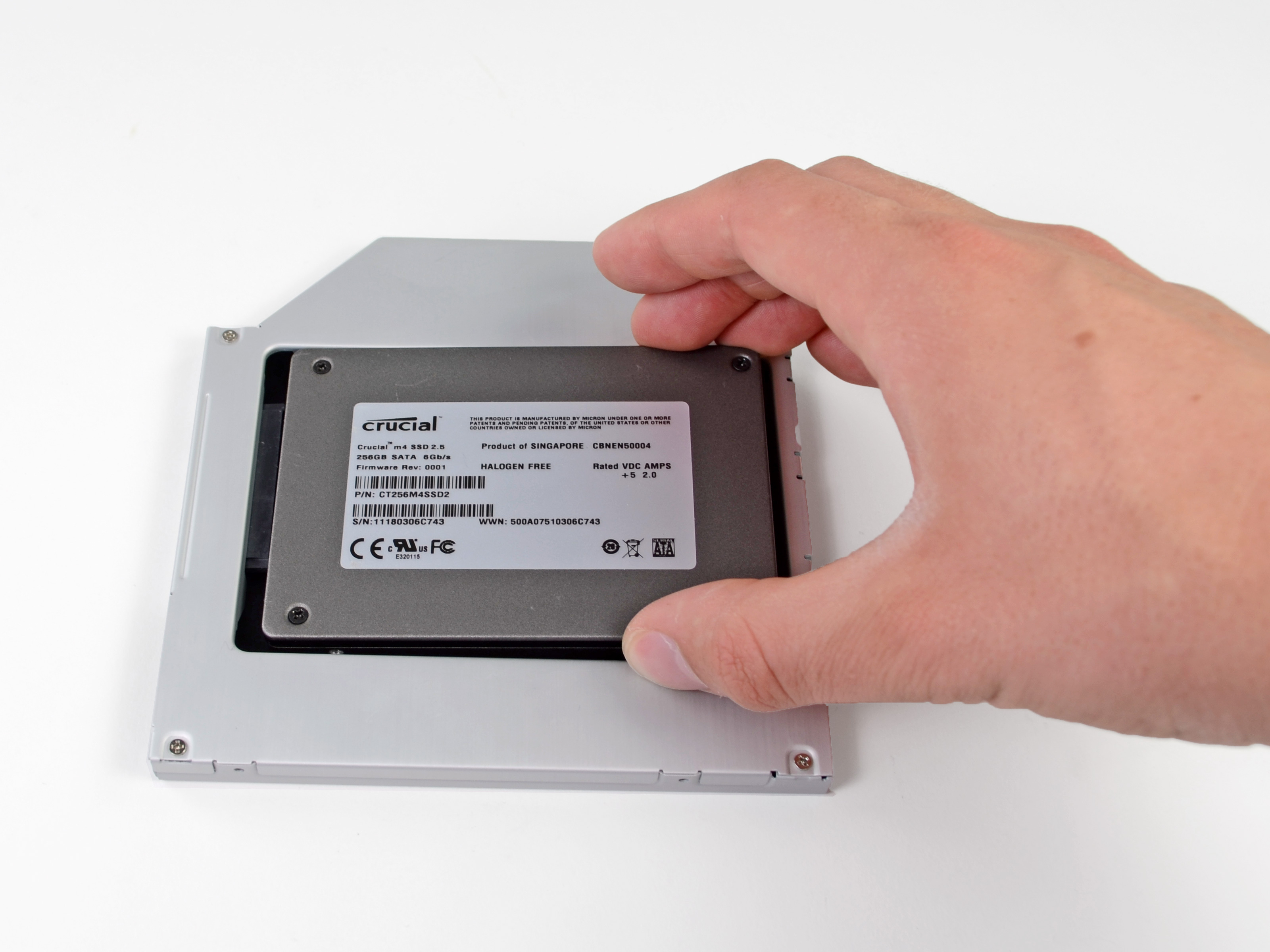

Image #1
Add Note Edit Step 13  ¶
  • Lift the left edge of the optical drive slightly and pull it away from the right side of the outer case.
Image #1 Image #2
Add Note Edit Step 14 — Optical Drive Replacement  ¶
  • Peel back the portion of aluminum tape highlighted in red, leaving the rest attached to the black plastic optical drive bracket.
    • It is not necessary to peel all of the EMI tape off the optical drive bracket.
Image #1 Image #2
Add Note Edit Step 15  ¶
  • Remove the two T10 Torx screws from each side of the optical drive (four screws total).
Image #1 Image #2 Image #3
Add Note Edit Step 16  ¶
  • Use the tip of a spudger to press each of the optical drive bracket tabs out of their slots on the bottom of the optical drive.
  • Rotate the optical drive bracket slightly away from the optical drive.
  • Pull the optical drive bracket away from the open end of the optical drive, minding any tabs that may get caught.
