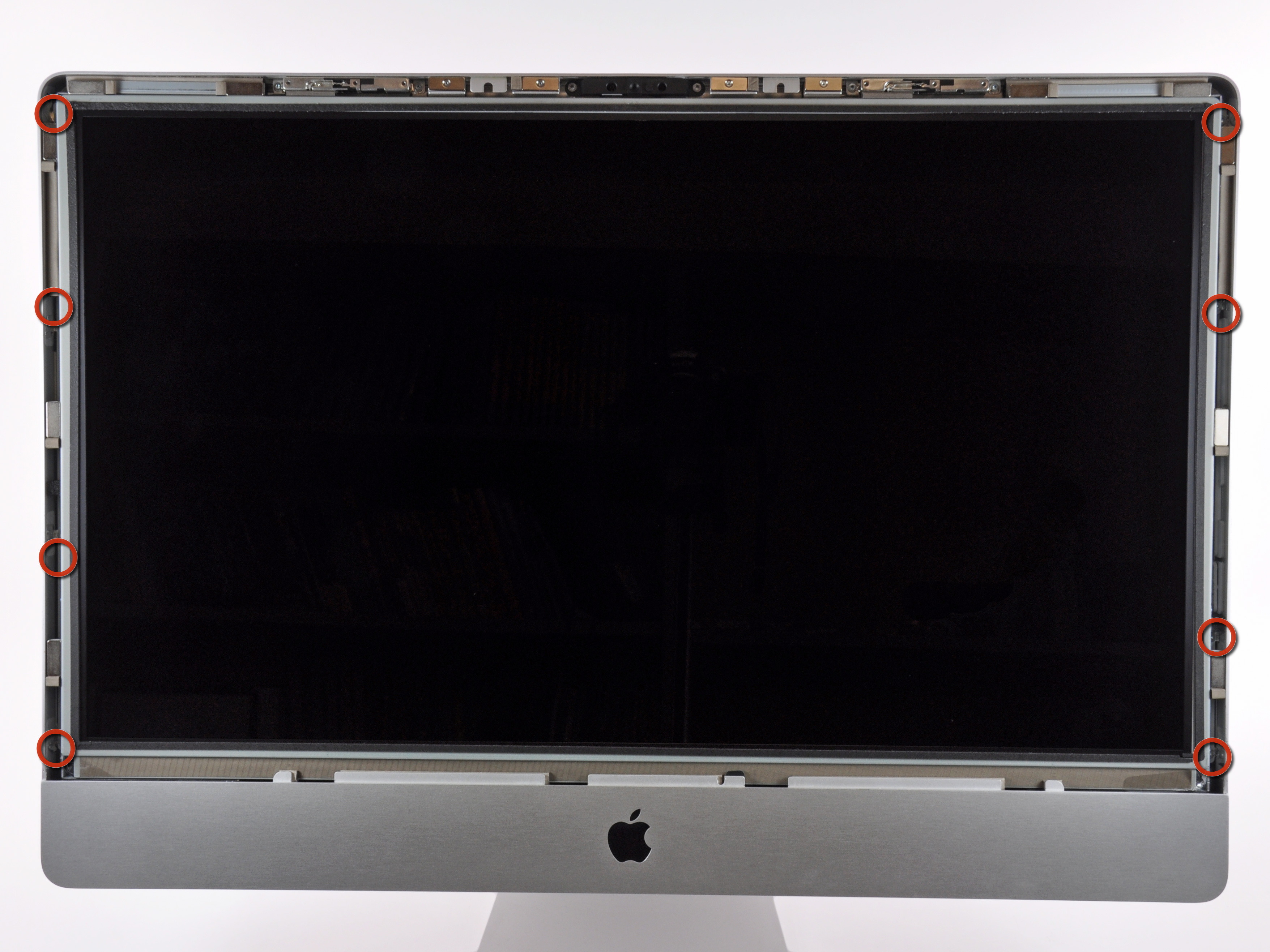

Add Note Edit Step 3 — Display  ¶
  • Remove the eight T10 Torx screws securing the LCD to the outer case.
Image #1 Image #2 Image #3
