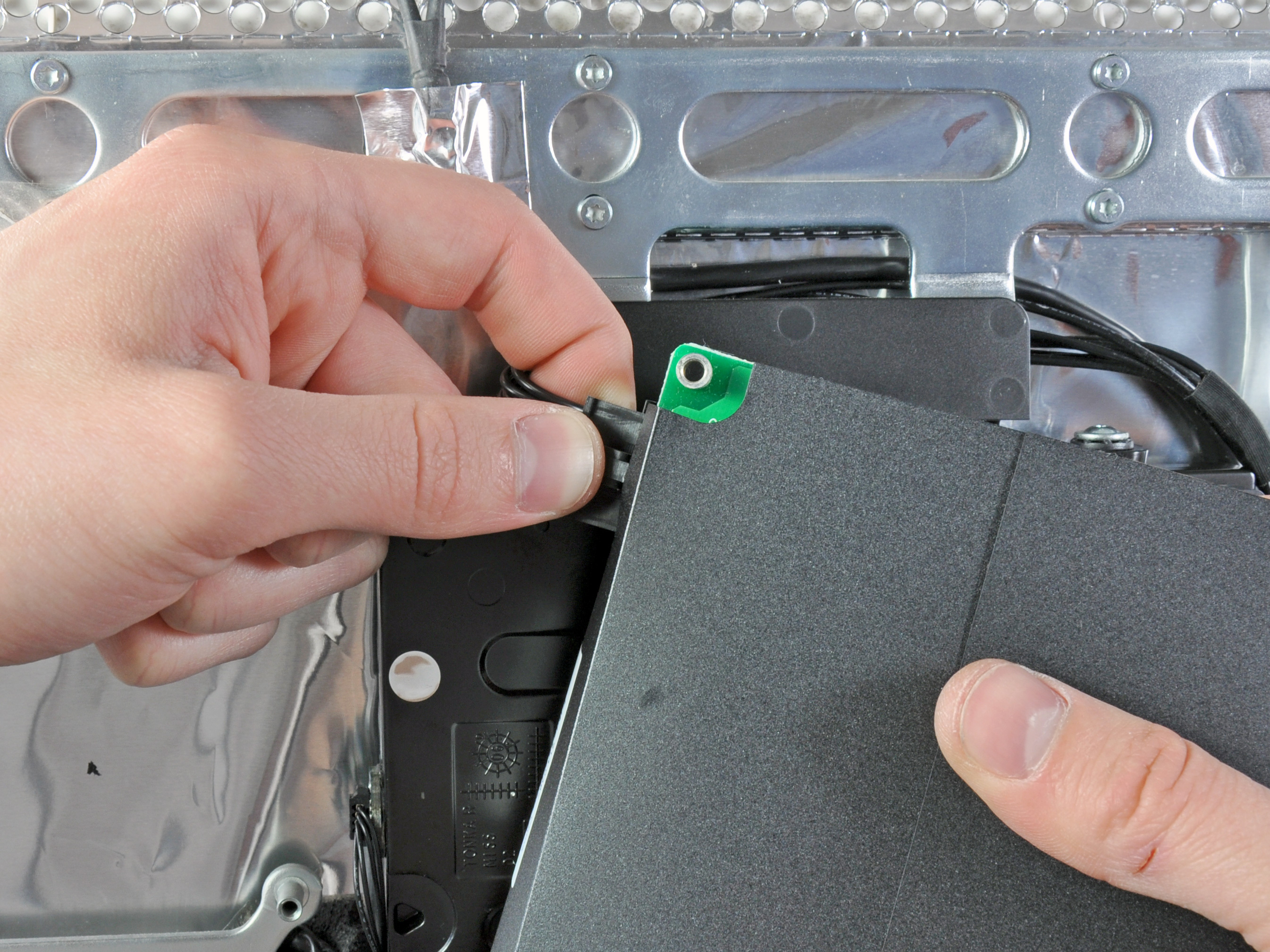

Add Note Edit Step 15  ¶
  • Rotate the power supply out of the rear case from its left side.
  • Disconnect the DC-Out cable by depressing the lock on the connector while pulling it away from its socket on the power supply.
first image
Add Note Edit Step 16  ¶
  • Disconnect the AC-In cable by disconnecting its lock while separating the two halves of its connector.
  • Remove the power supply from the iMac.
