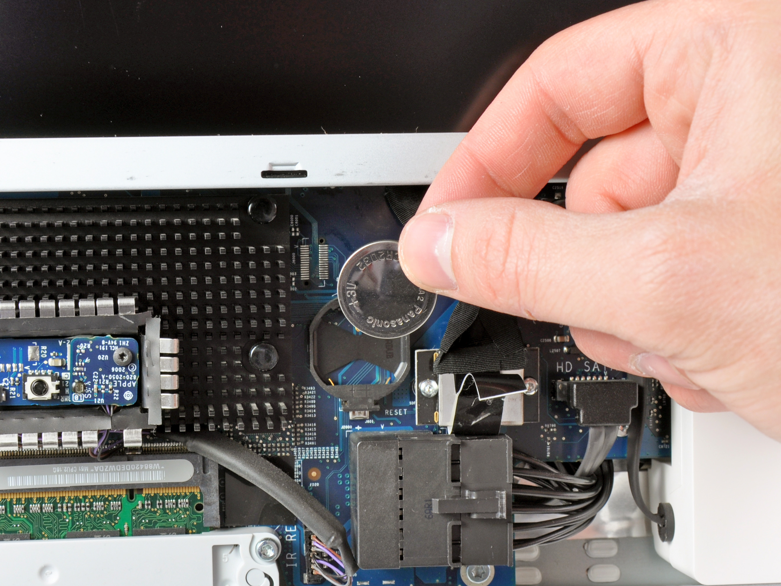

  7. iMac Intel 24" EMC 2111 PRAM Battery Replacement, PRAM Battery: step 7, image 1 of 2 iMac Intel 24" EMC 2111 PRAM Battery Replacement, PRAM Battery: step 7, image 2 of 2
    • Use the tip of a spudger to pry the PRAM battery out of its socket on the logic board.
    • Remove the PRAM battery.
    • Be sure to replace the battery with a new CR2032 Lithium battery cell.
